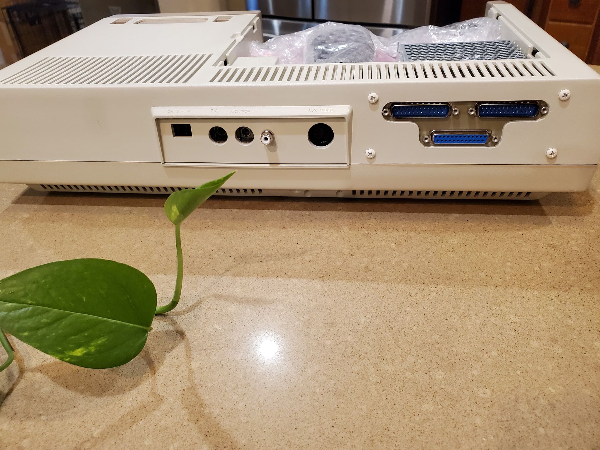

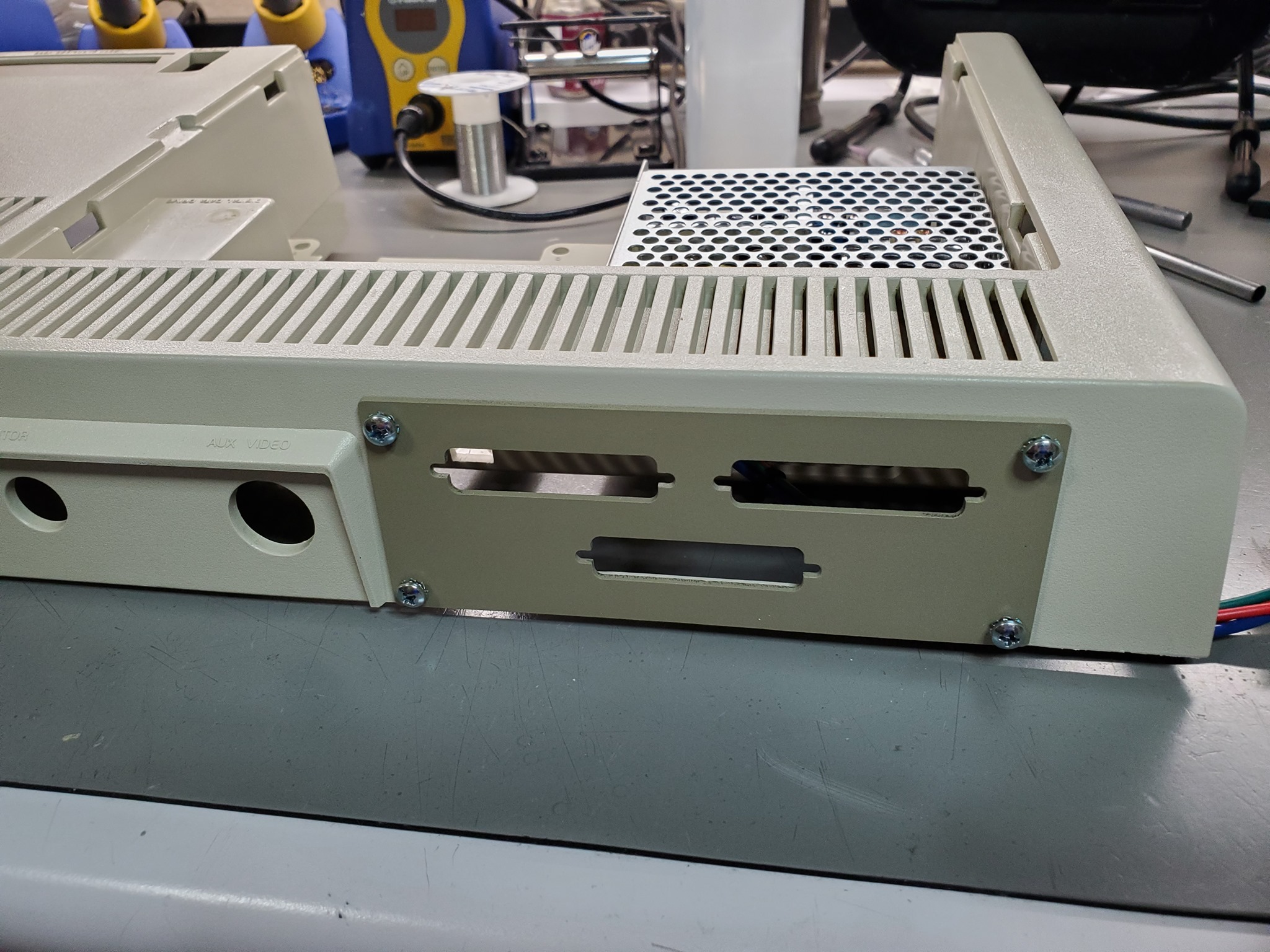

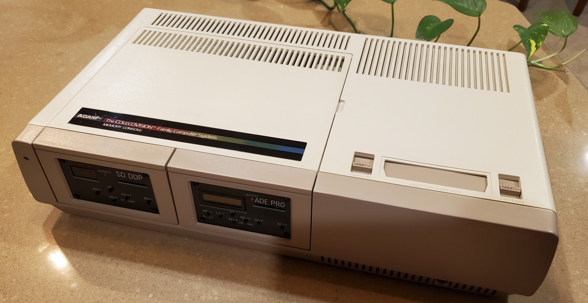

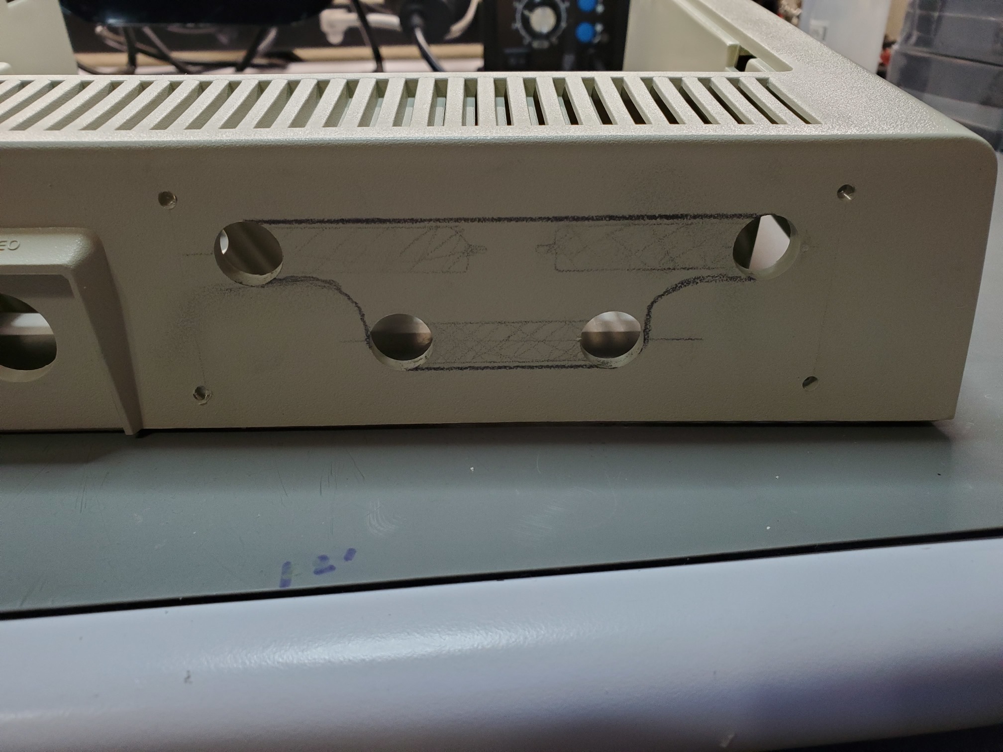

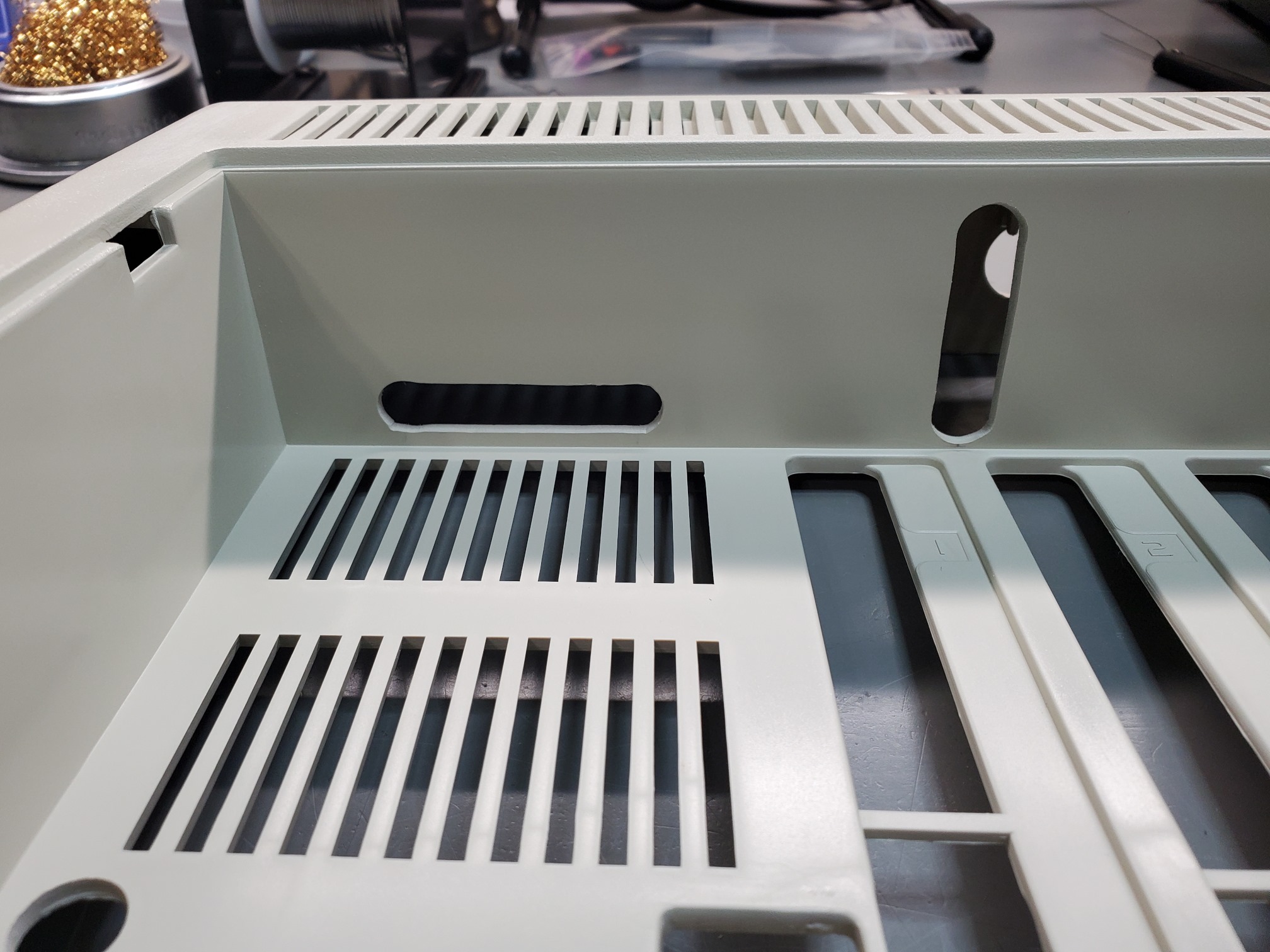

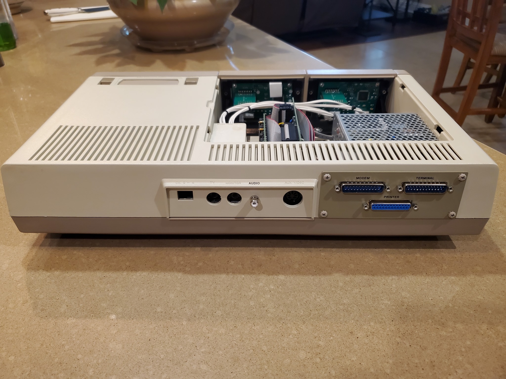

Case & Cosmetics
  • - Rarer dark beige bottom consoles for the first two units made available

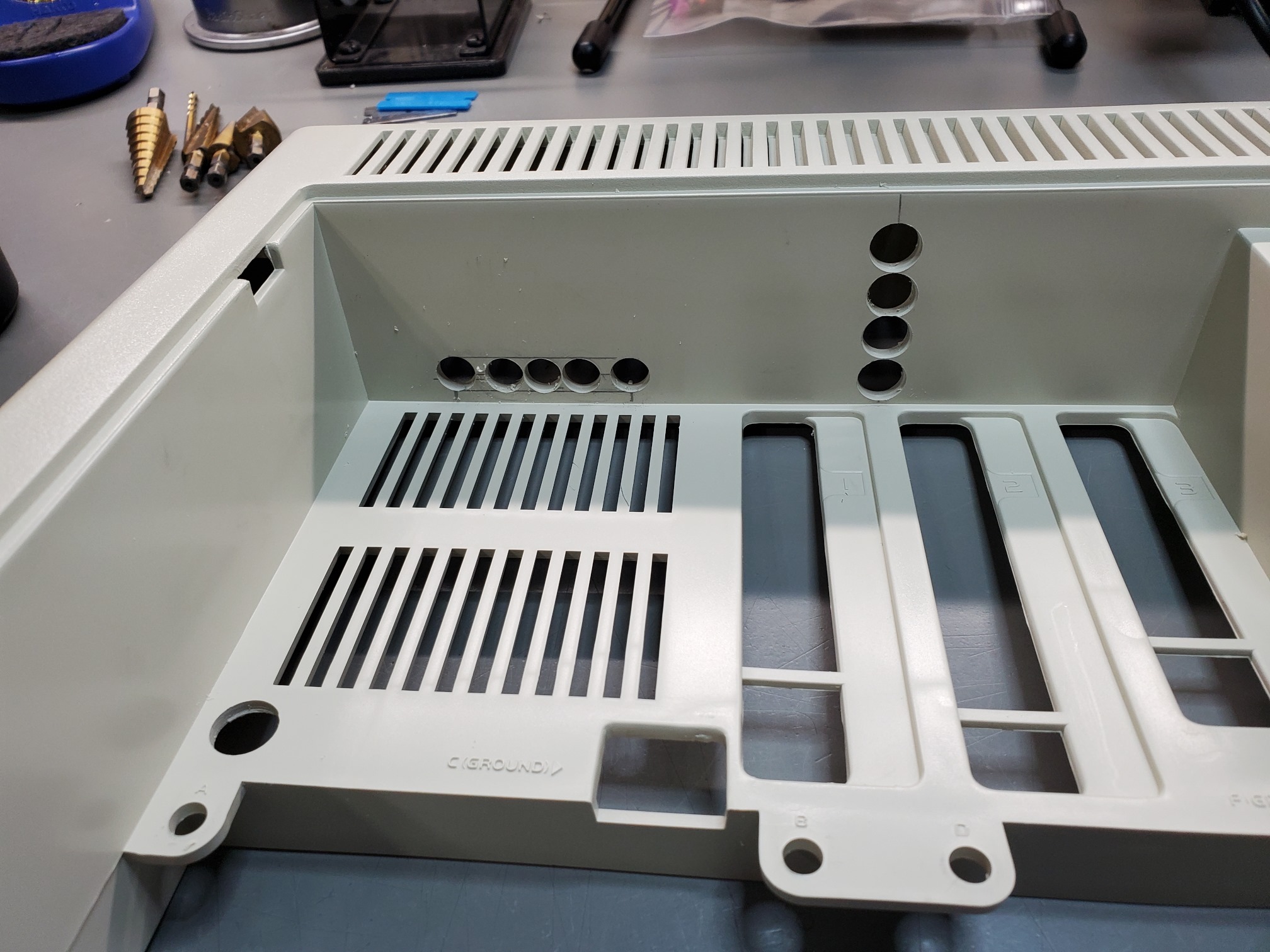

  • - Case modifications to cleanly route internal power supply, terminal, parallel, and external data drive cables utilizing a custom machined dark beige powder coated metal COM bracket mounted on the back. Nothing hangs out the top cover

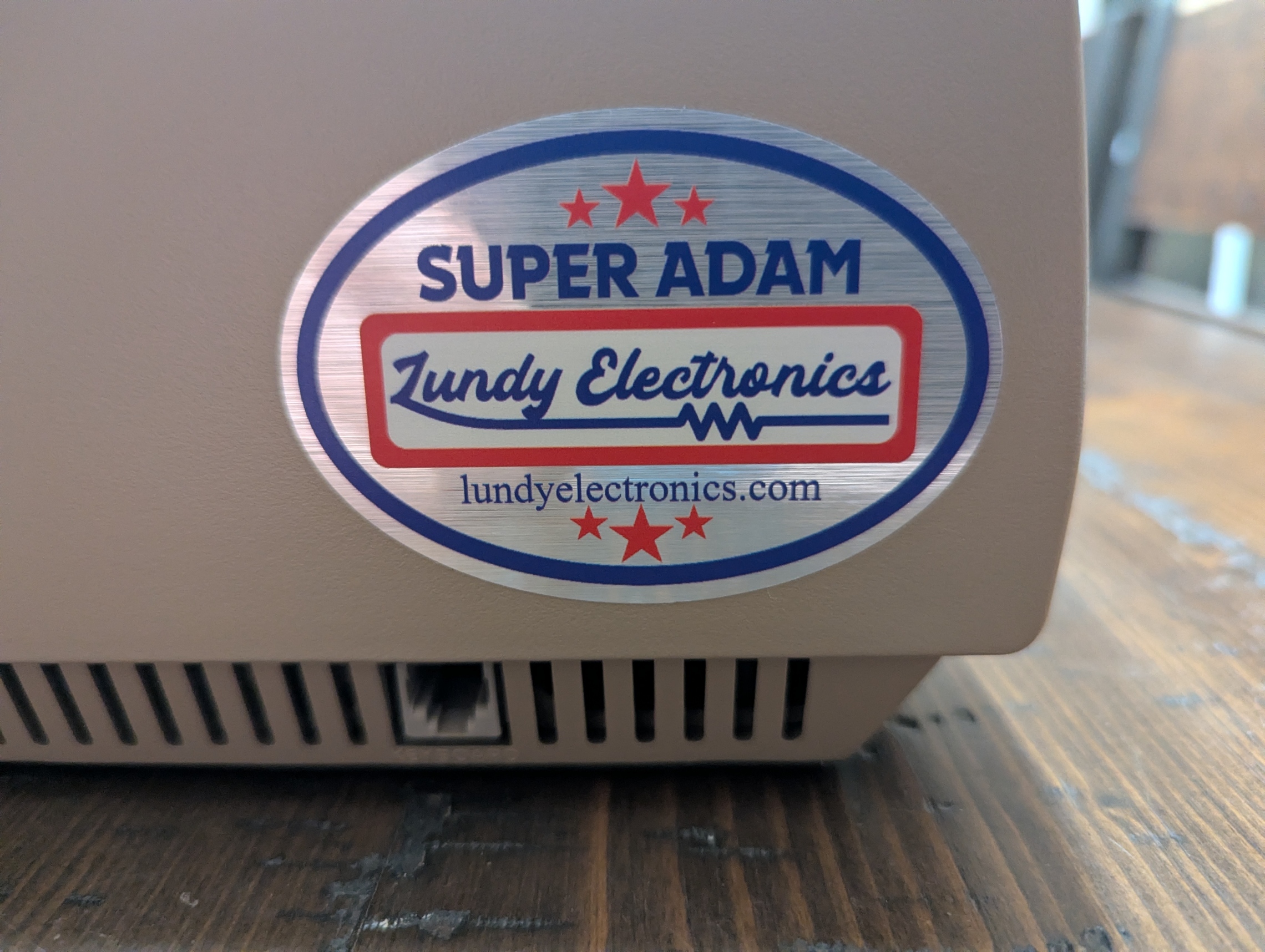

  • - Professionally printed brushed aluminum SuperADAM front decal
  • - Thoroughly cleaned console with new label set. Best effort to find matching dummy data drive bezels to house the internal drive emulators
  • - New proper sponge rubber feet

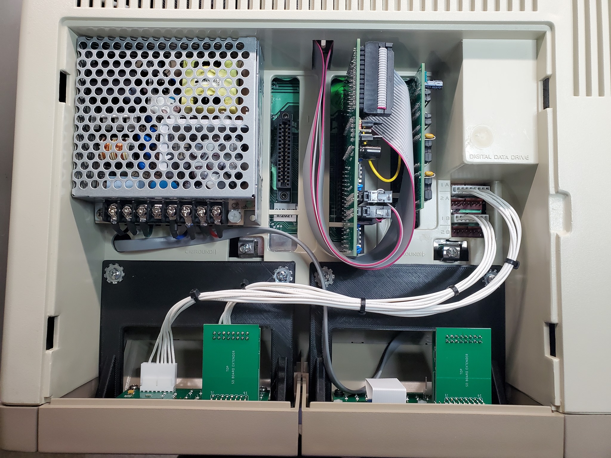

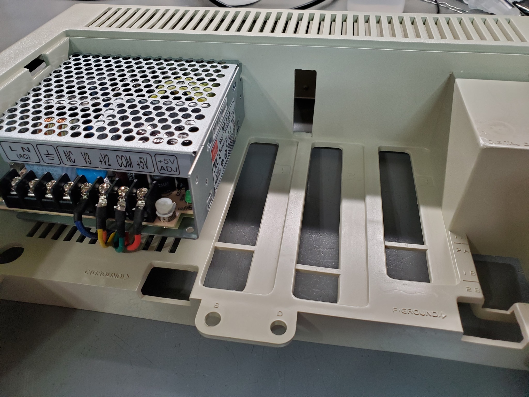

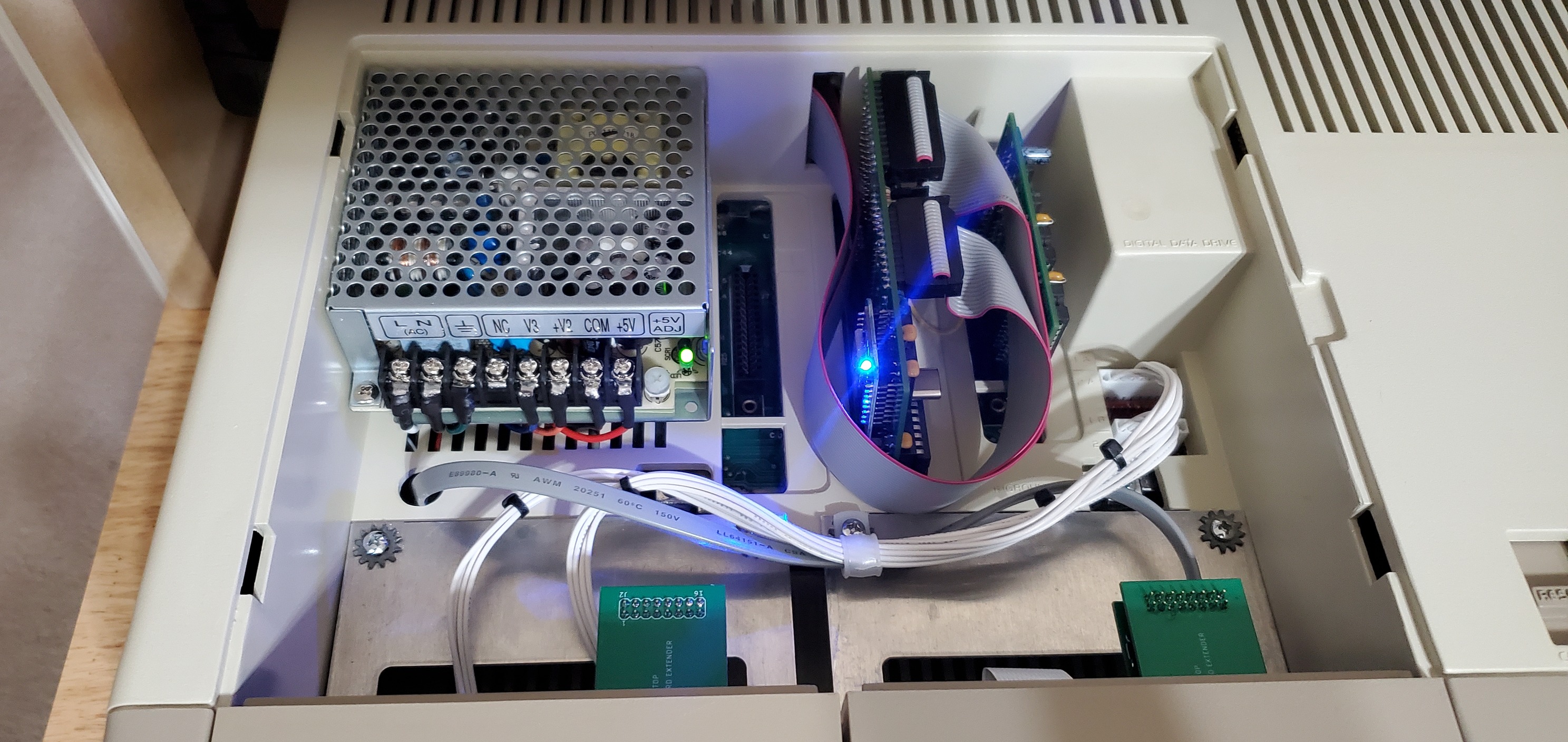

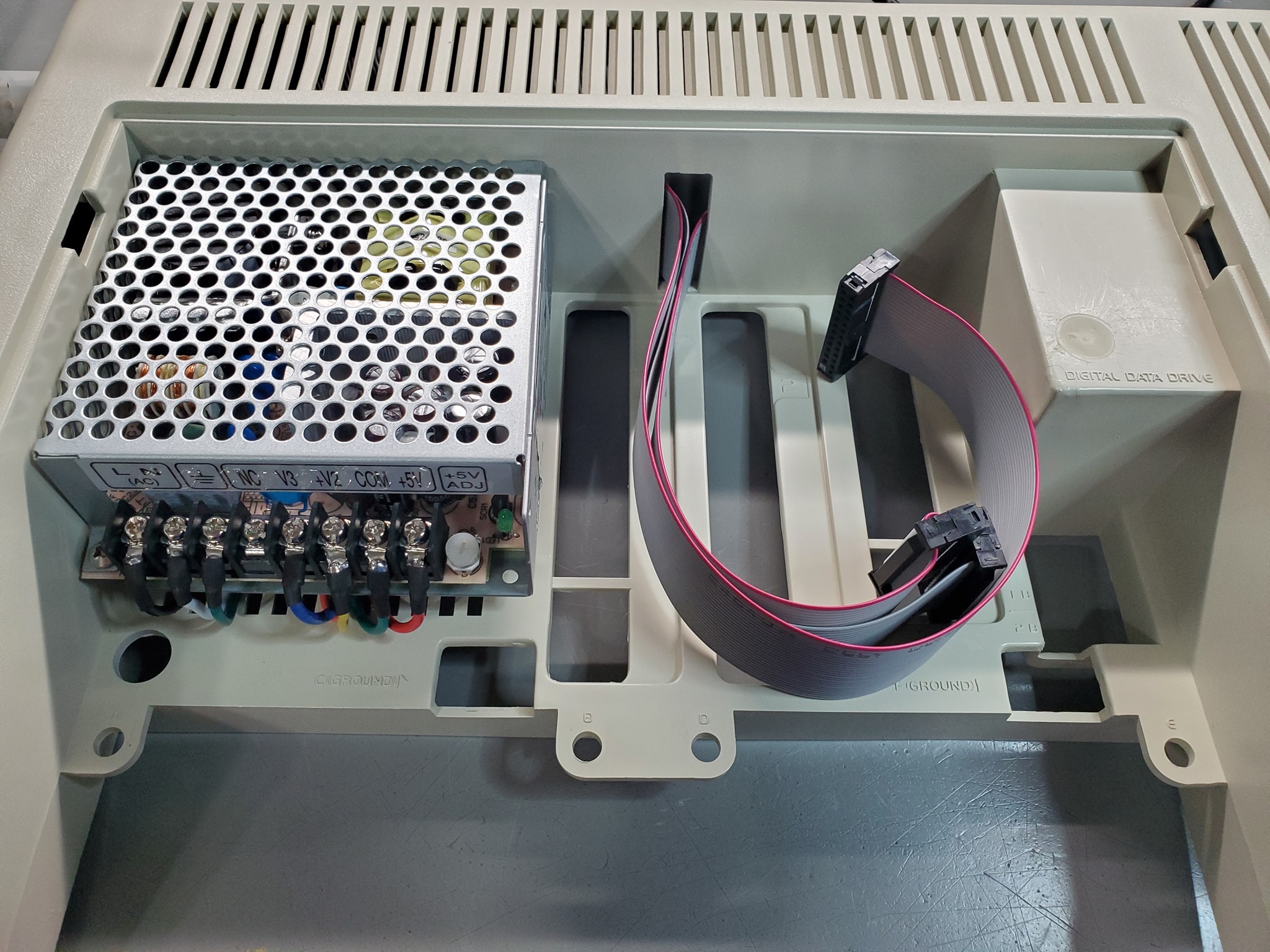

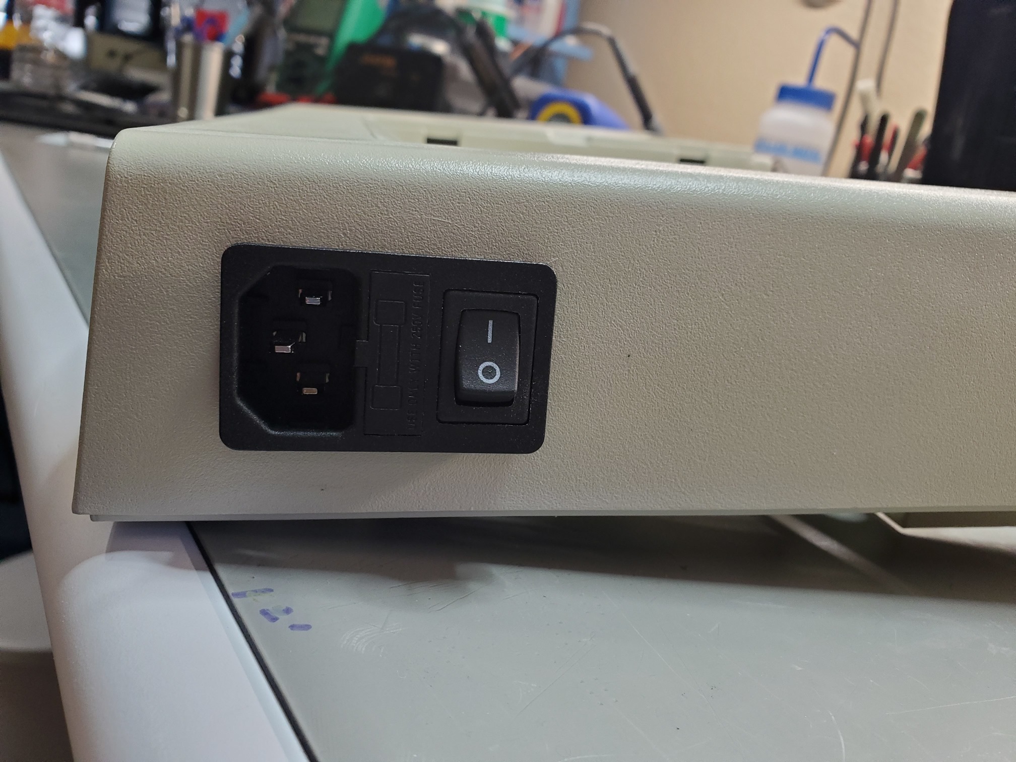

Power
  • - Internal power supply
  • - Rear IEC fused power input module
  • - Left side mounted power switch towards the front
  • - Red LED power indicator on front left

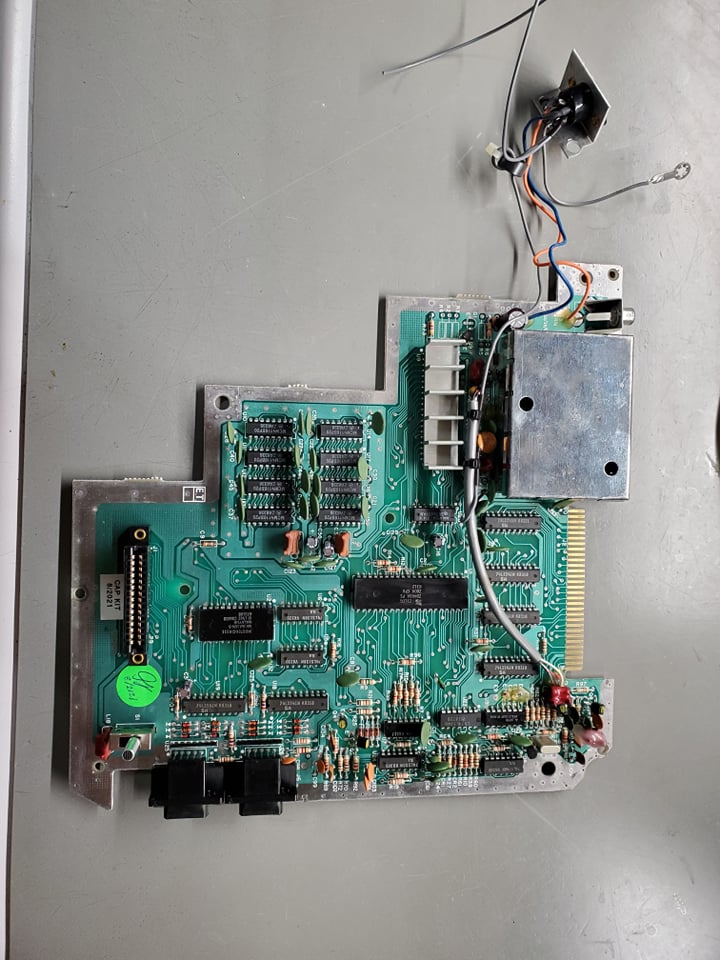

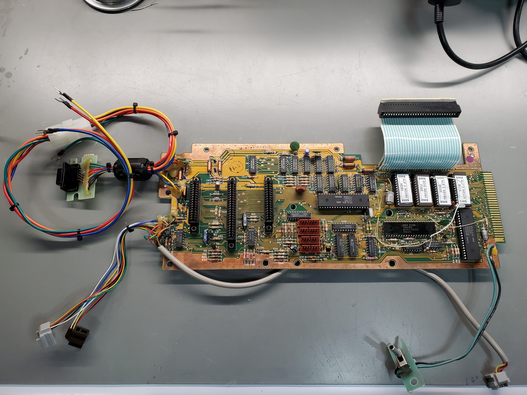

Board Upgrades
  • - Complete capacitor kit, including tantalum capacitors
  • - New cartridge connector for reliability
  • - Delta board DRAM to SRAM converter
  • - Gamma board DRAM to SRAM converter (new product — not yet publicly released)
  • - Thoroughly cleaned PCB and polished I/O fingers
  • - Ultrasonic cleaned joystick connectors

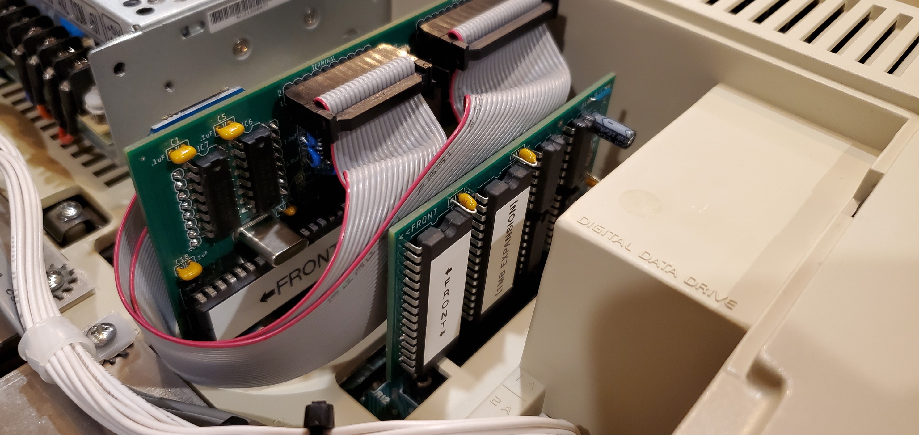

Connectivity & Expansion
  • - MIB238-WiFi board (WiFi modem, terminal, parallel port, expansion ROM socket, and memory addressor signal generator connection)
  • - 1MB RAM Expander board
  • - Internal ADAMnet board connection with printer reset silencer. Still allows +5 out of side power connector to power a roller controller and factory printer ADAMnet connectivity

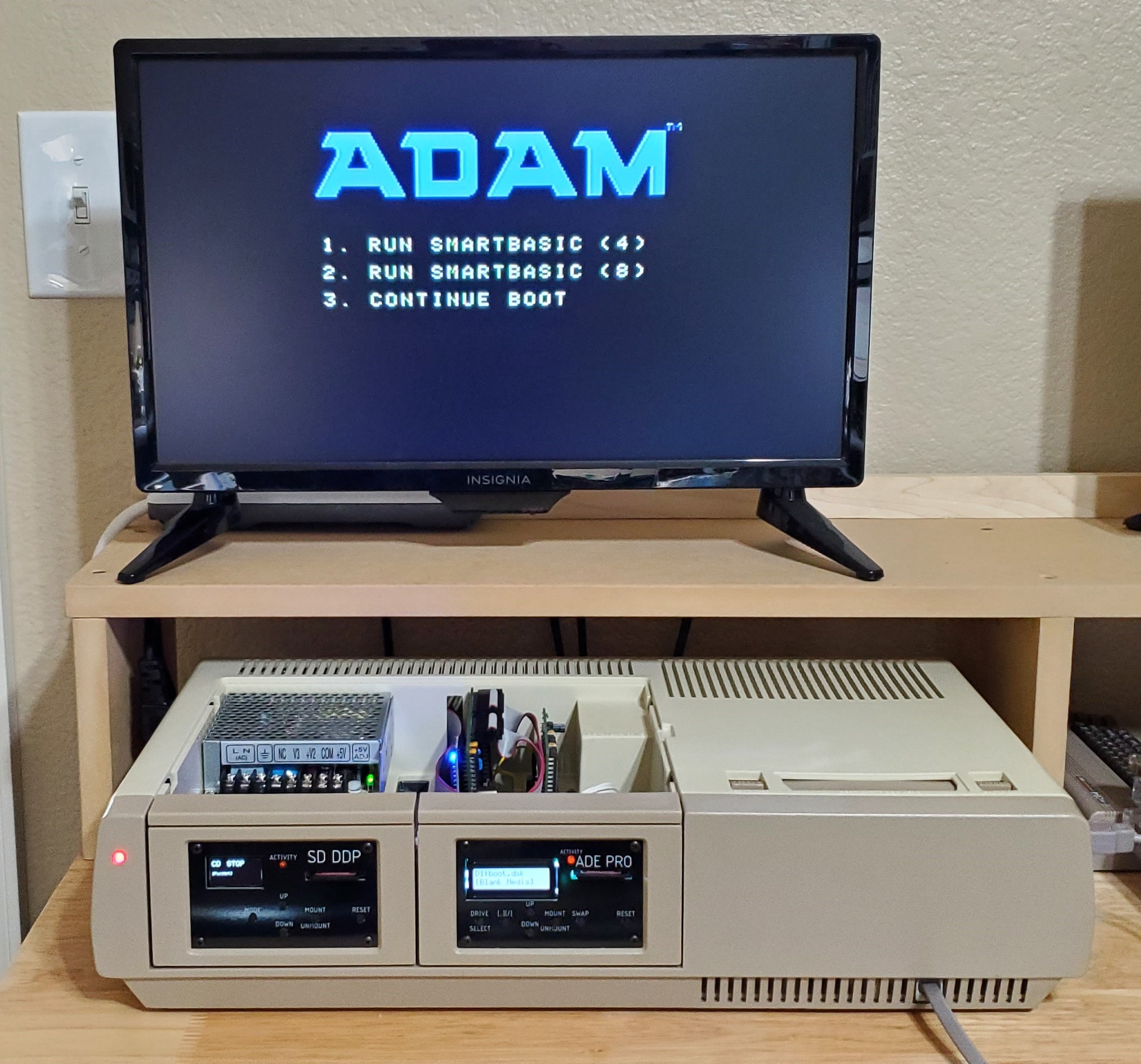

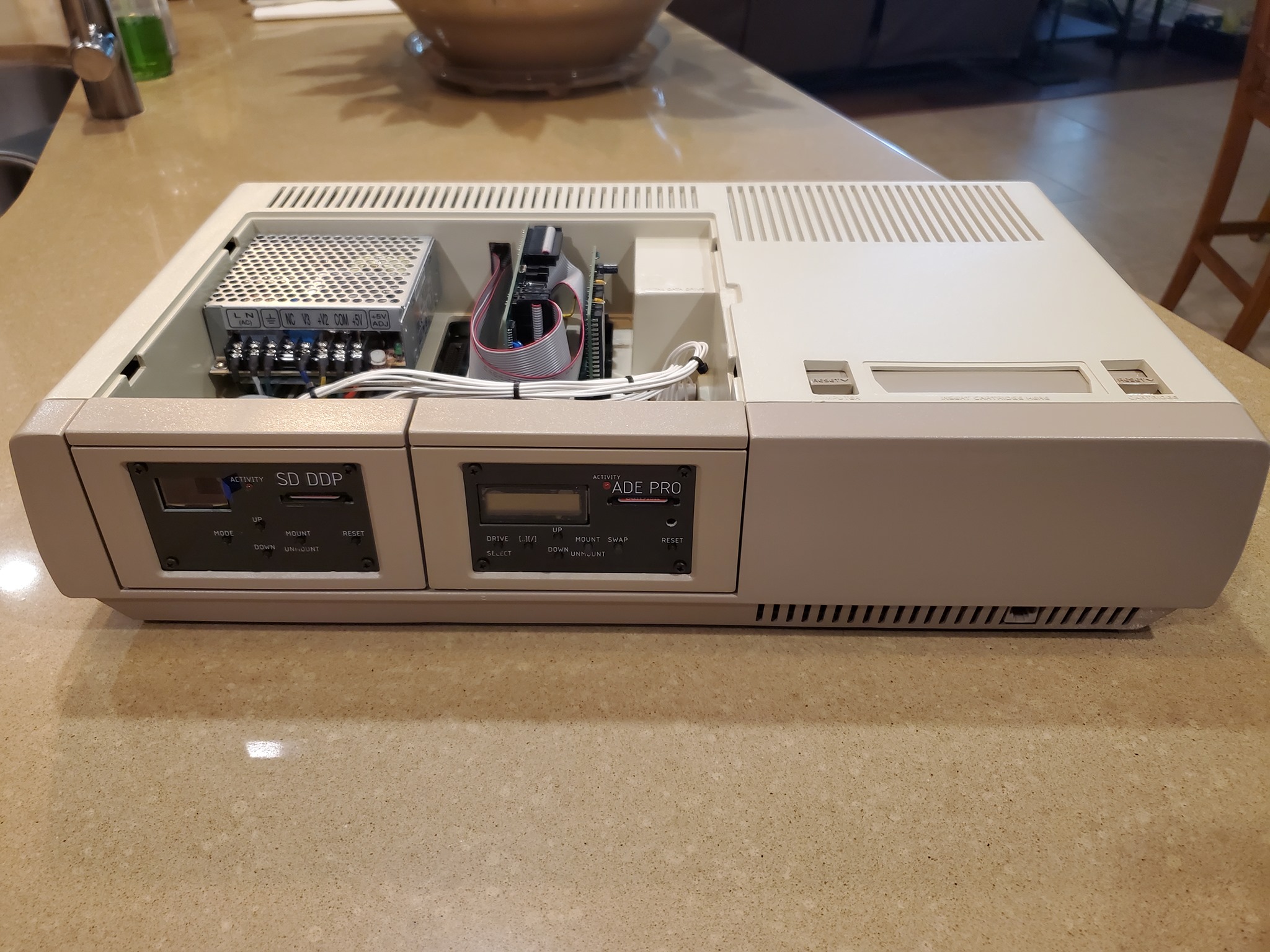

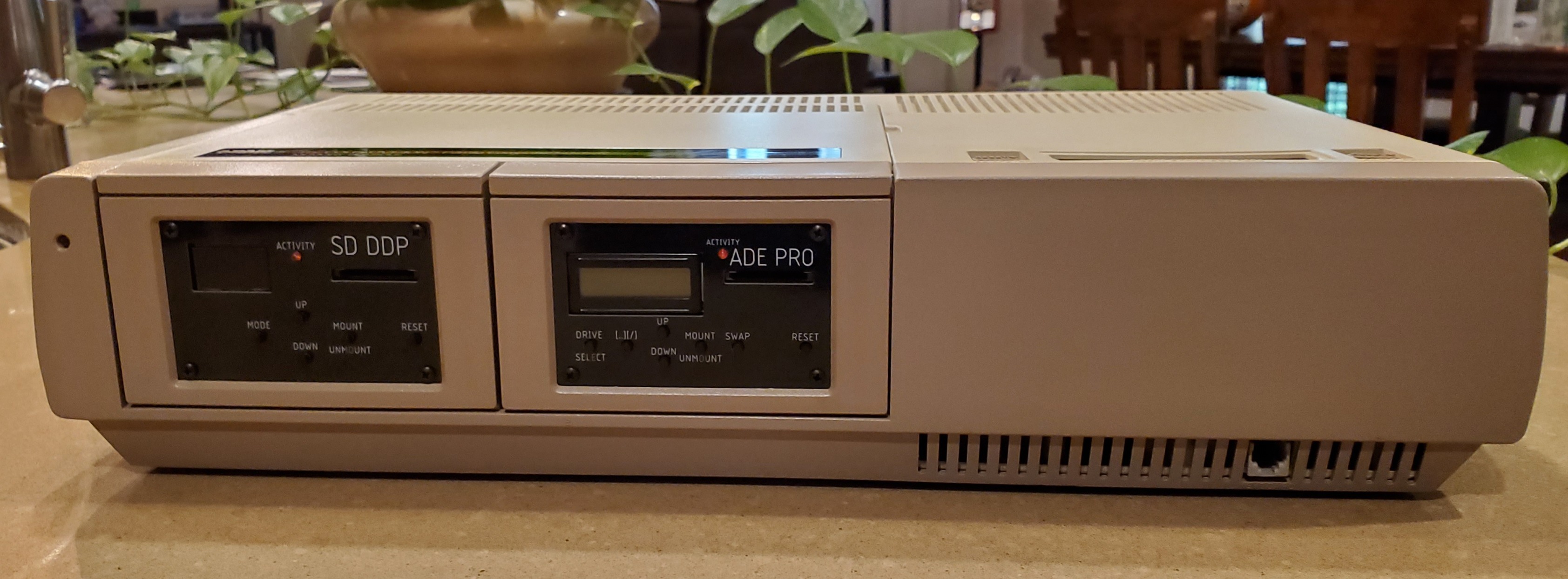

Storage

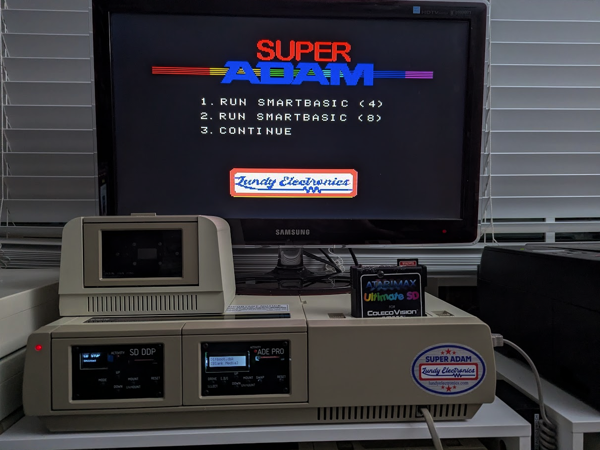

  • - Internal drive emulator (ADE)
  • - SD DDP (internal SD data drive)
  • - External data drive, housing, and cable
Software
  • - SmartBASIC XROM in MIB238 boot ROM socket — Console can boot instantaneously to SmartBASIC

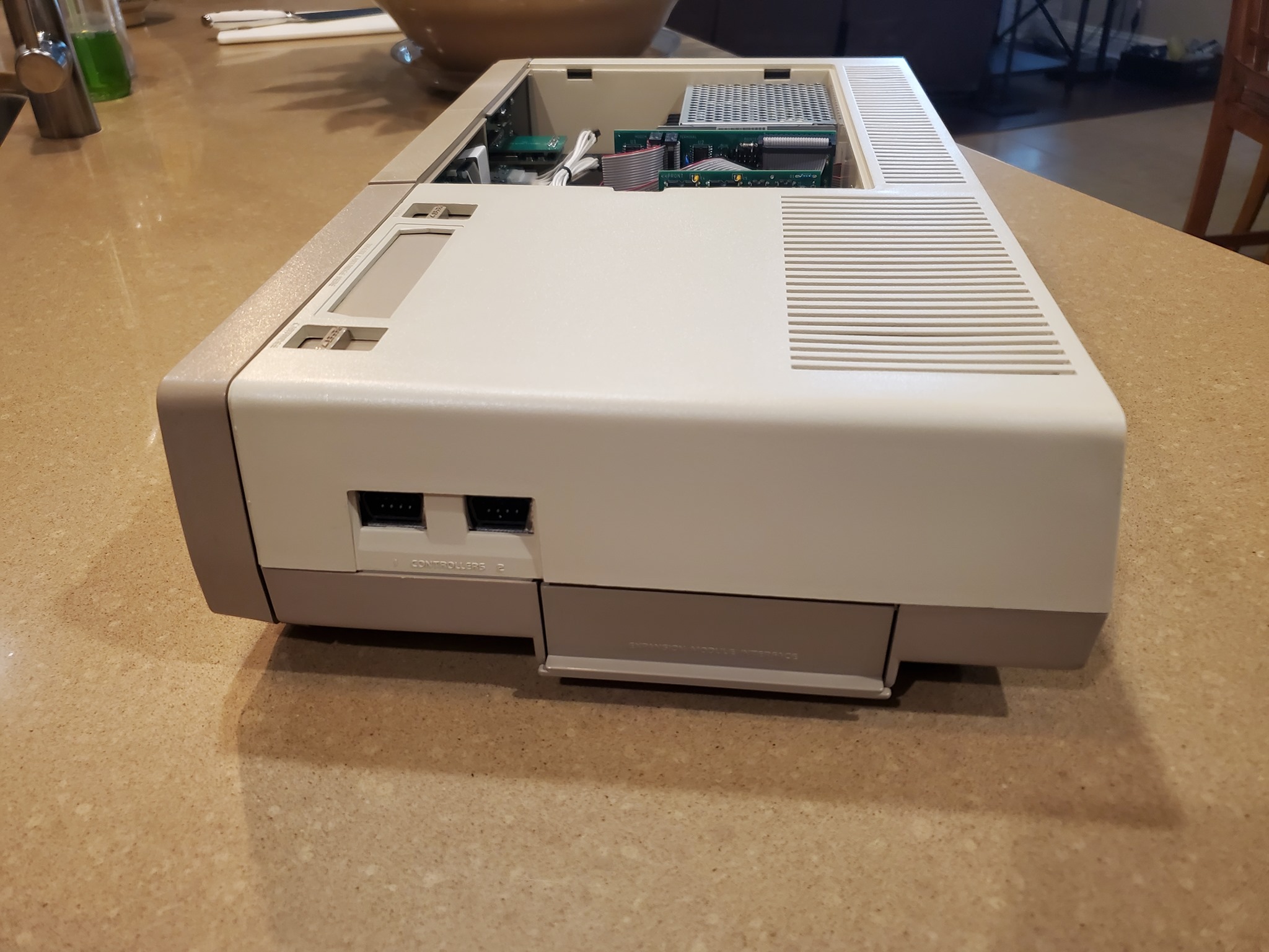

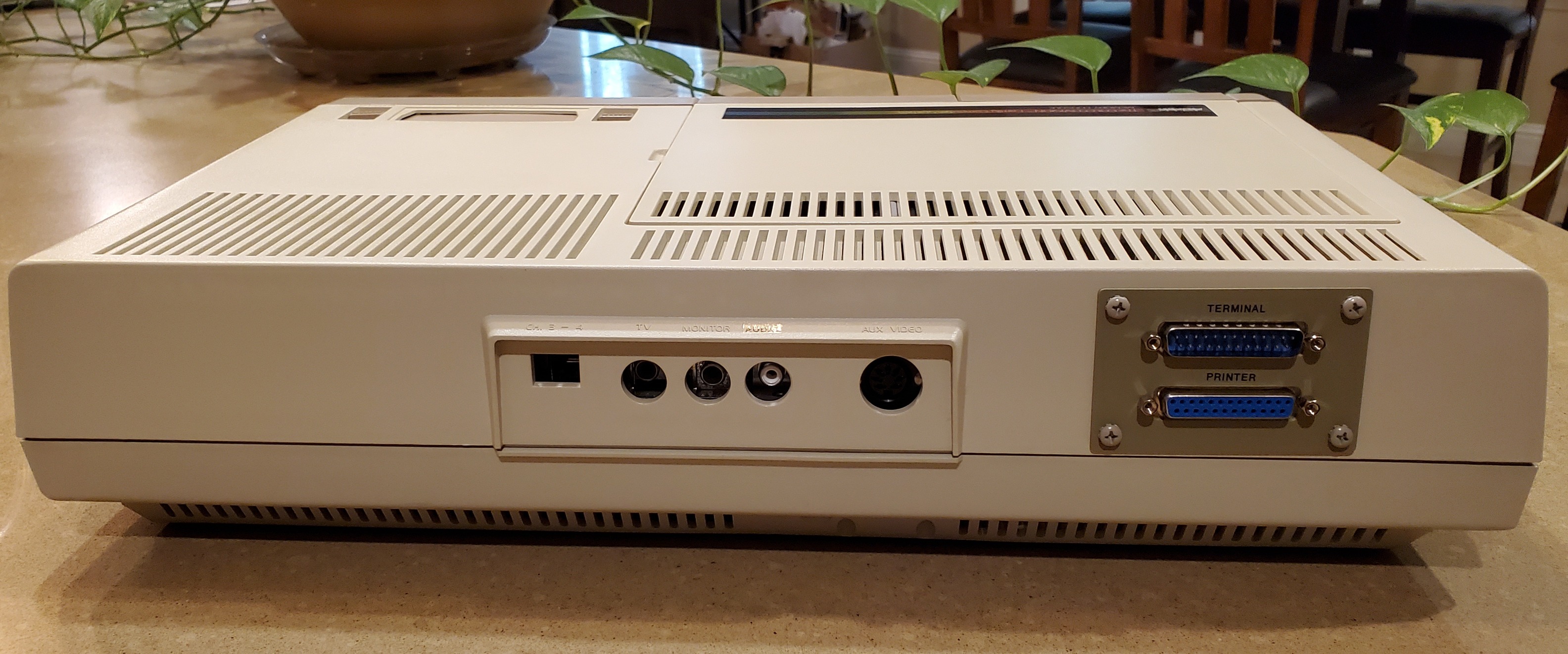

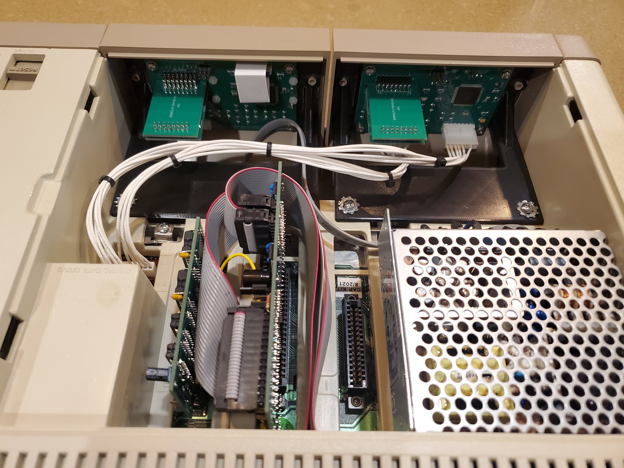

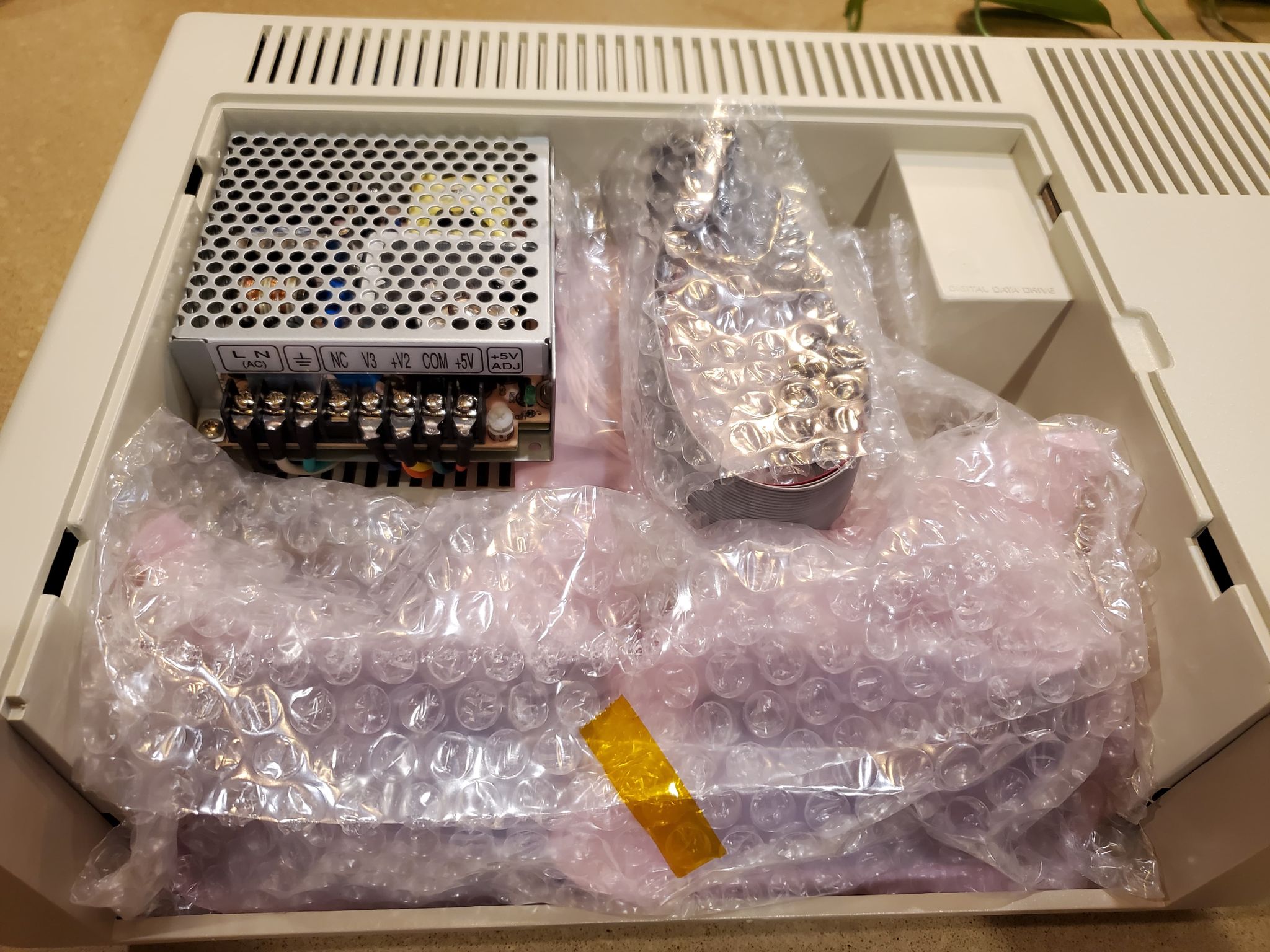

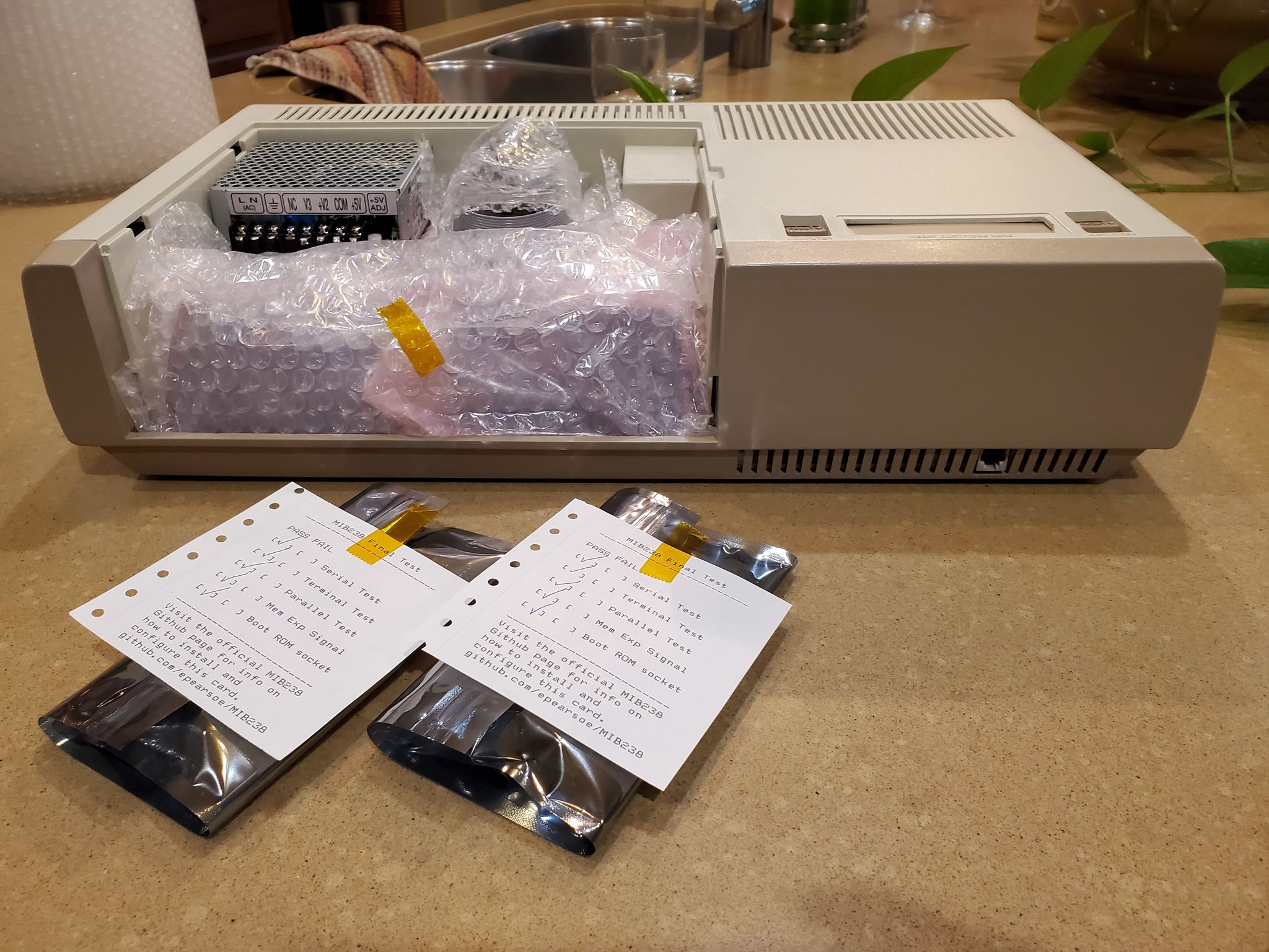

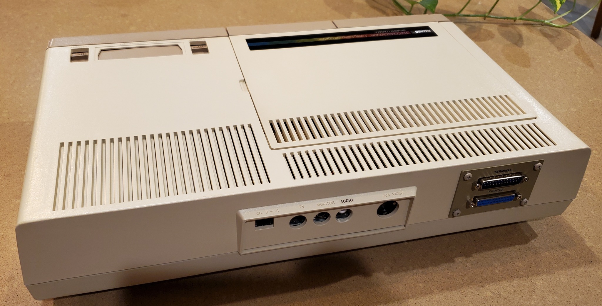

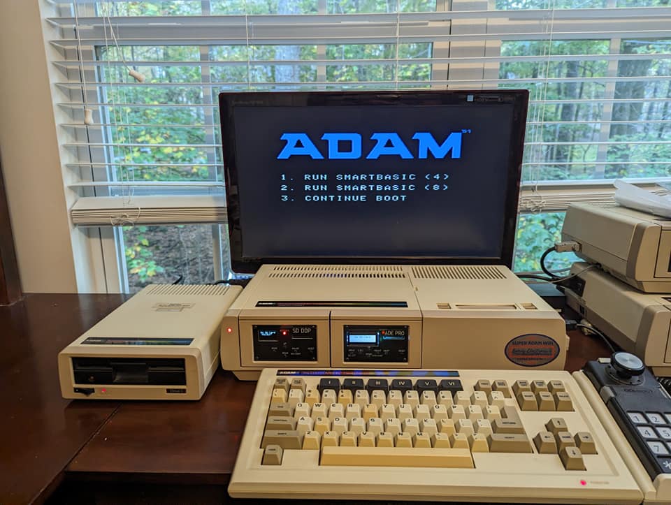

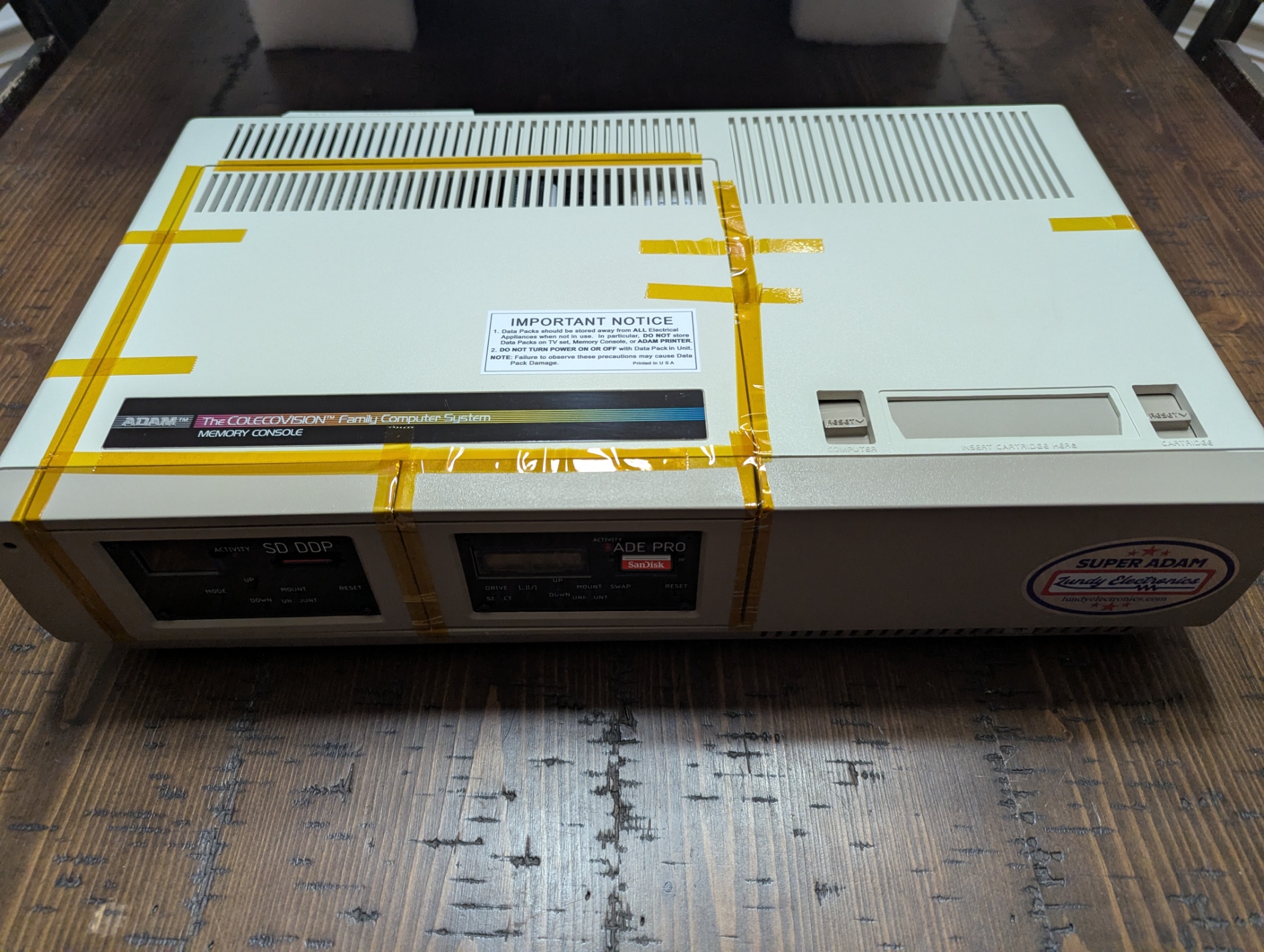

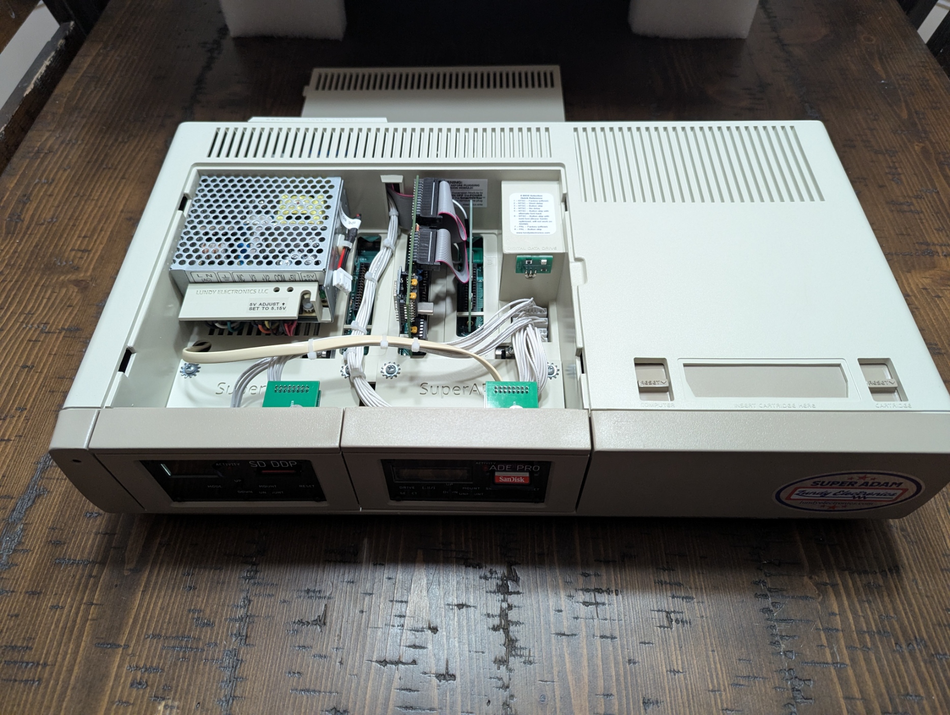

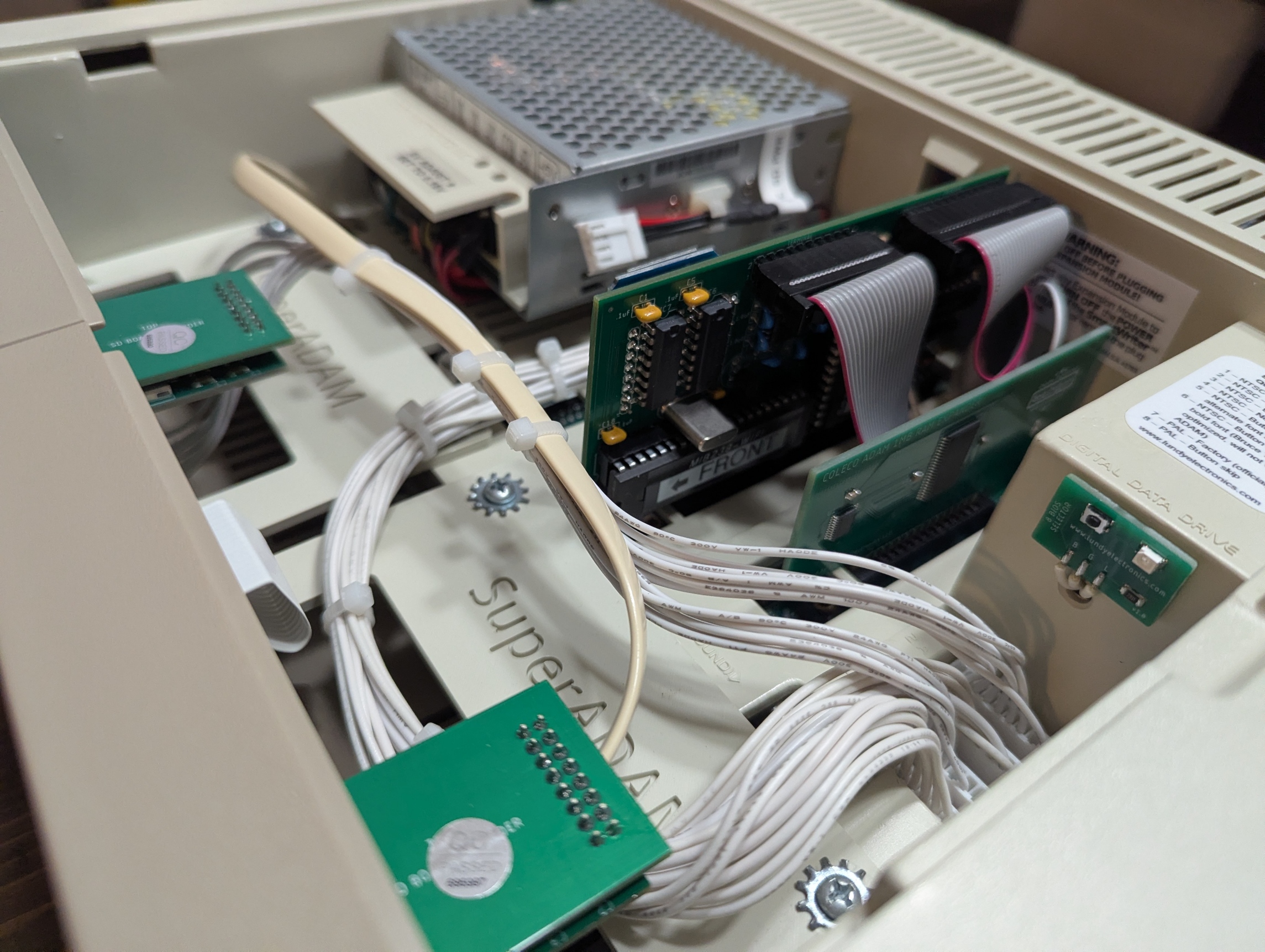

SuperADAM WiFi
SuperADAM WiFi System
Modified by John Lundy

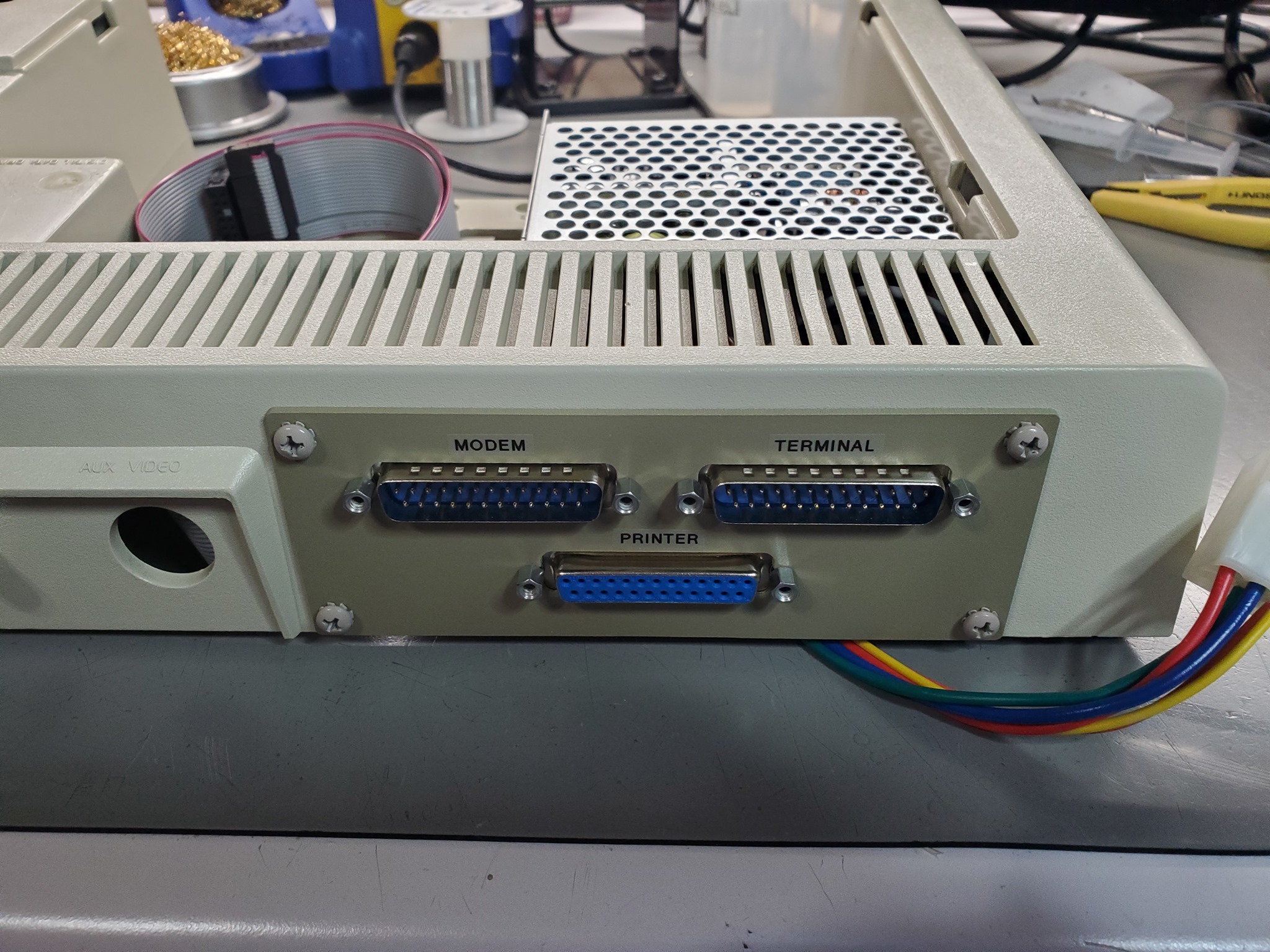

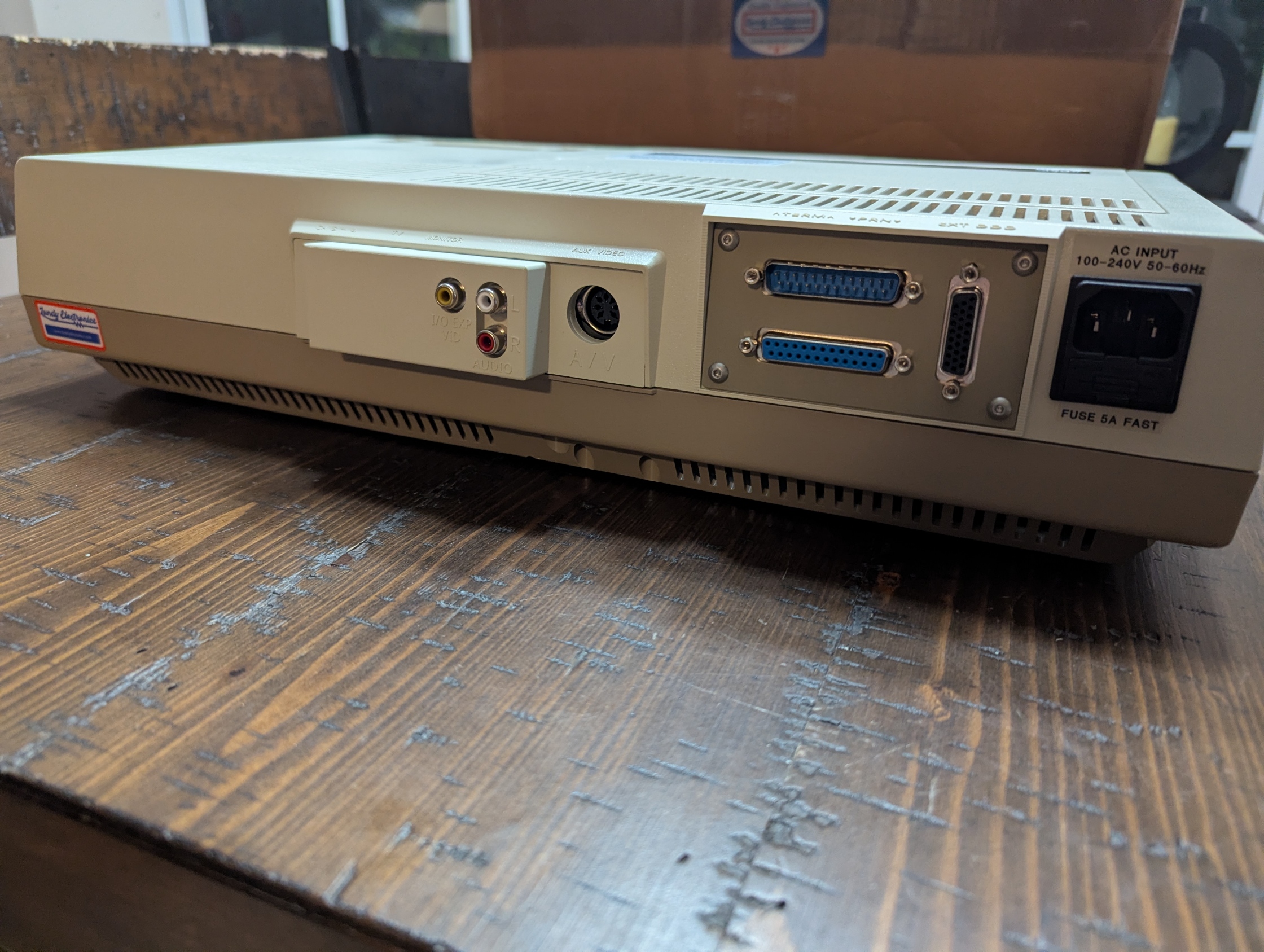

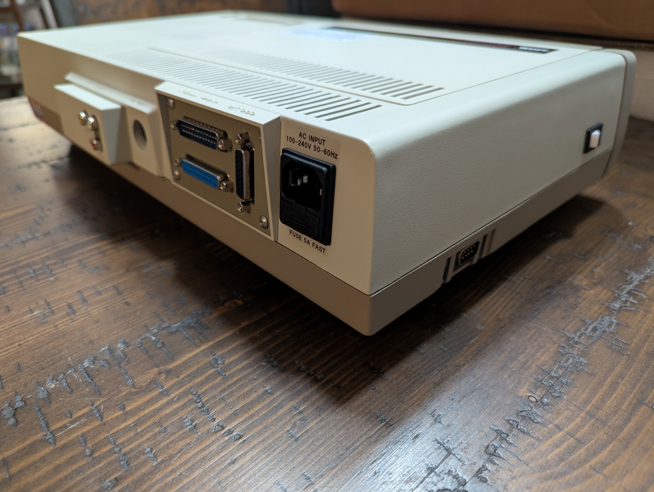

Case & Cosmetics
  • - Console itself
  • - Professionally machined and powder coated COM panel bracket designed just for an ADAM console
  • - All connectors ultrasonically cleaned for reliable connections
  • - All hardware polished to a chrome finish
  • - Other misc parts, materials, wiring, and connectors to make this modded console

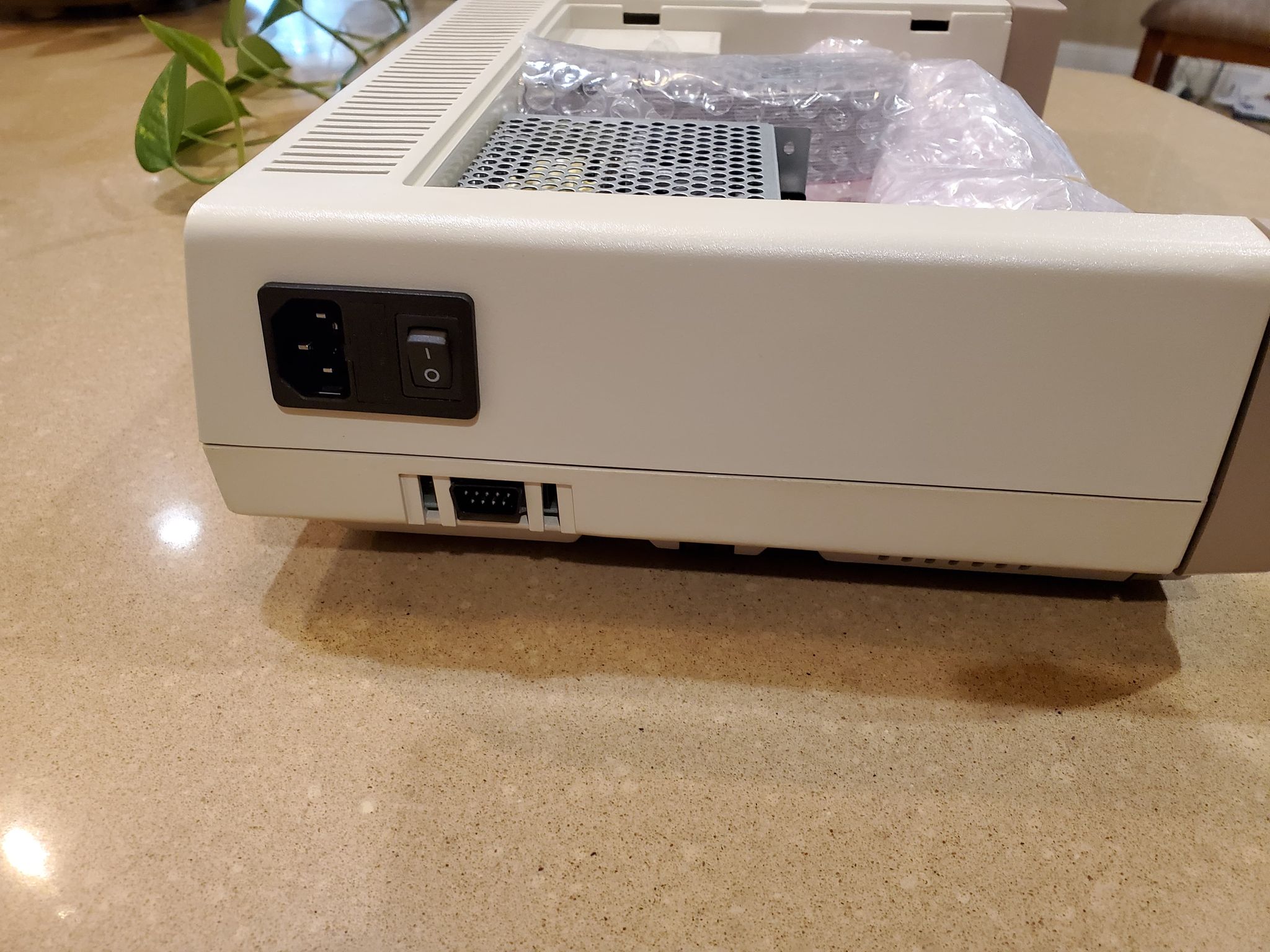

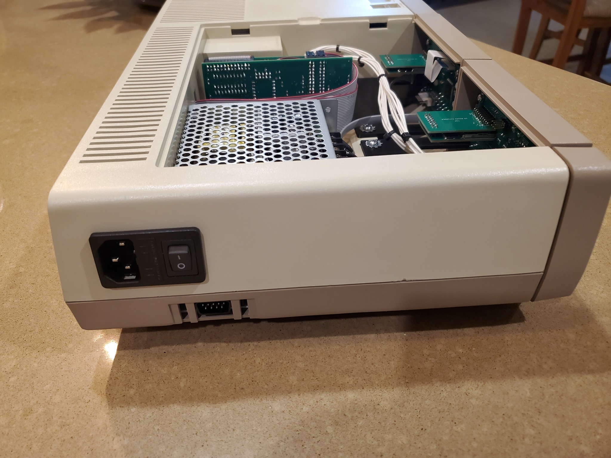

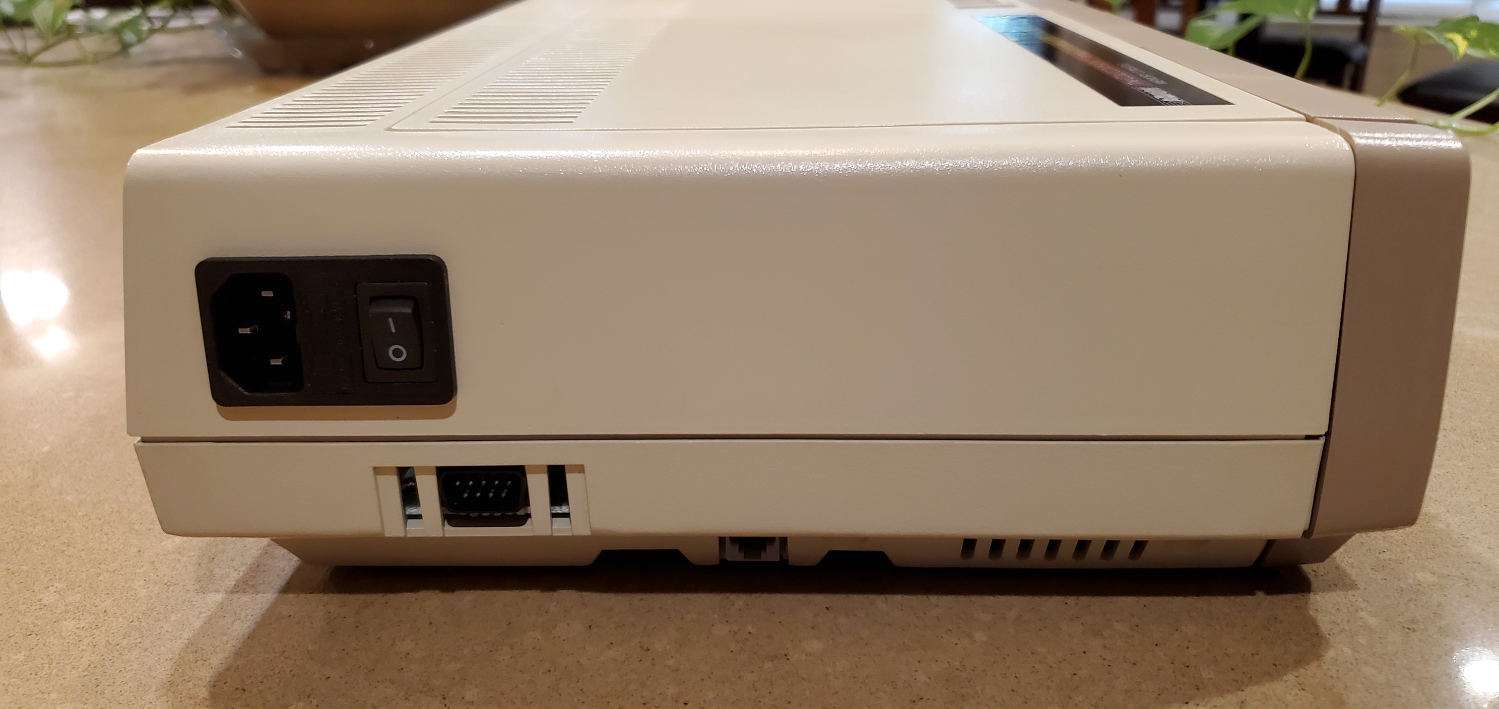

Power
  • - IEC fused power inlet module and power cord
Video & Audio
  • - Audio out RCA connector (audio can now be obtained without the need for the DIN connector)
  • - C88 sound balance mod
Board Upgrades
  • - All 4116 DRAM replaced with 4164 DRAM and sockets
  • - Complete electrolytic and tantalum cap kit
  • - MIB238-WiFi card (has WiFi modem, terminal serial port, parallel printer port, boot PROM, and memory expander signal generation connector)
  • - 1MB RAM Expander card
  • - Internal ADAMnet connector and cable
  • - ADAMnet to Coleco printer adapter with reset silence included for using a factory printer
  • - ADAMnet splitter to allow multiple ADAMnet devices on the single left side port if needed
  • - Two ADAMnet cables for future use
  • - 80-column terminal connector and internal ribbon cable
  • - Parallel printer connector and internal ribbon cable
  • - Memory expander signal wire

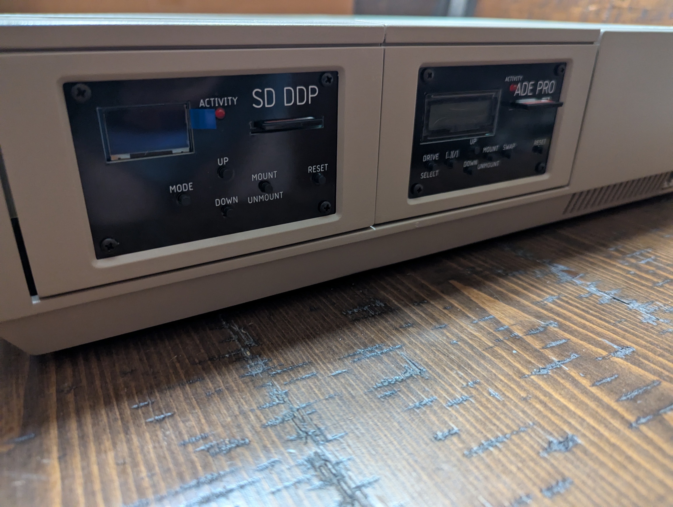

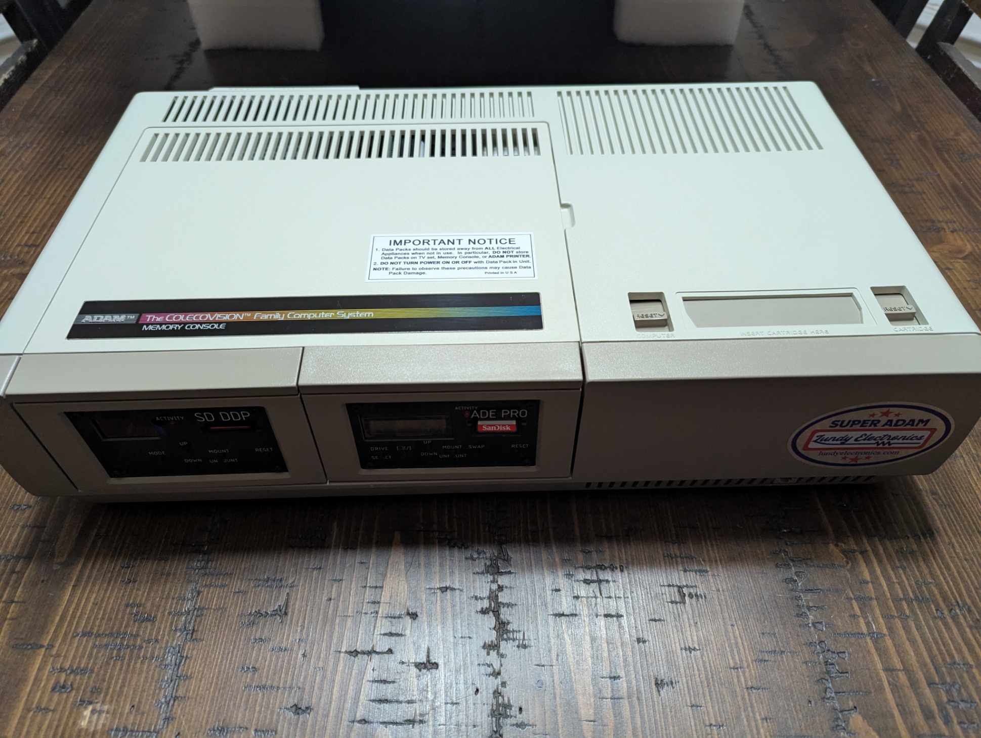

Storage
  • - Internal ADE Pro
  • - SD DDP
Software
  • - SmartBASIC boot PROM with integrated AJM printer port #64 patch
  • - R89 SmartWRITER PROMs with parallel printer support built in
SuperADAM WiFi Gallery

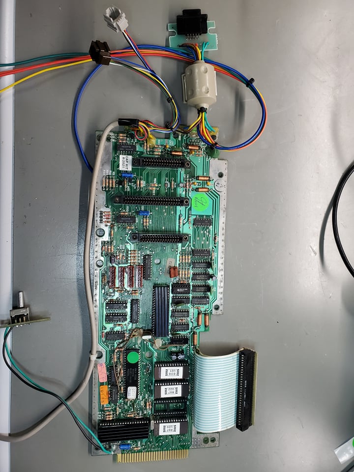

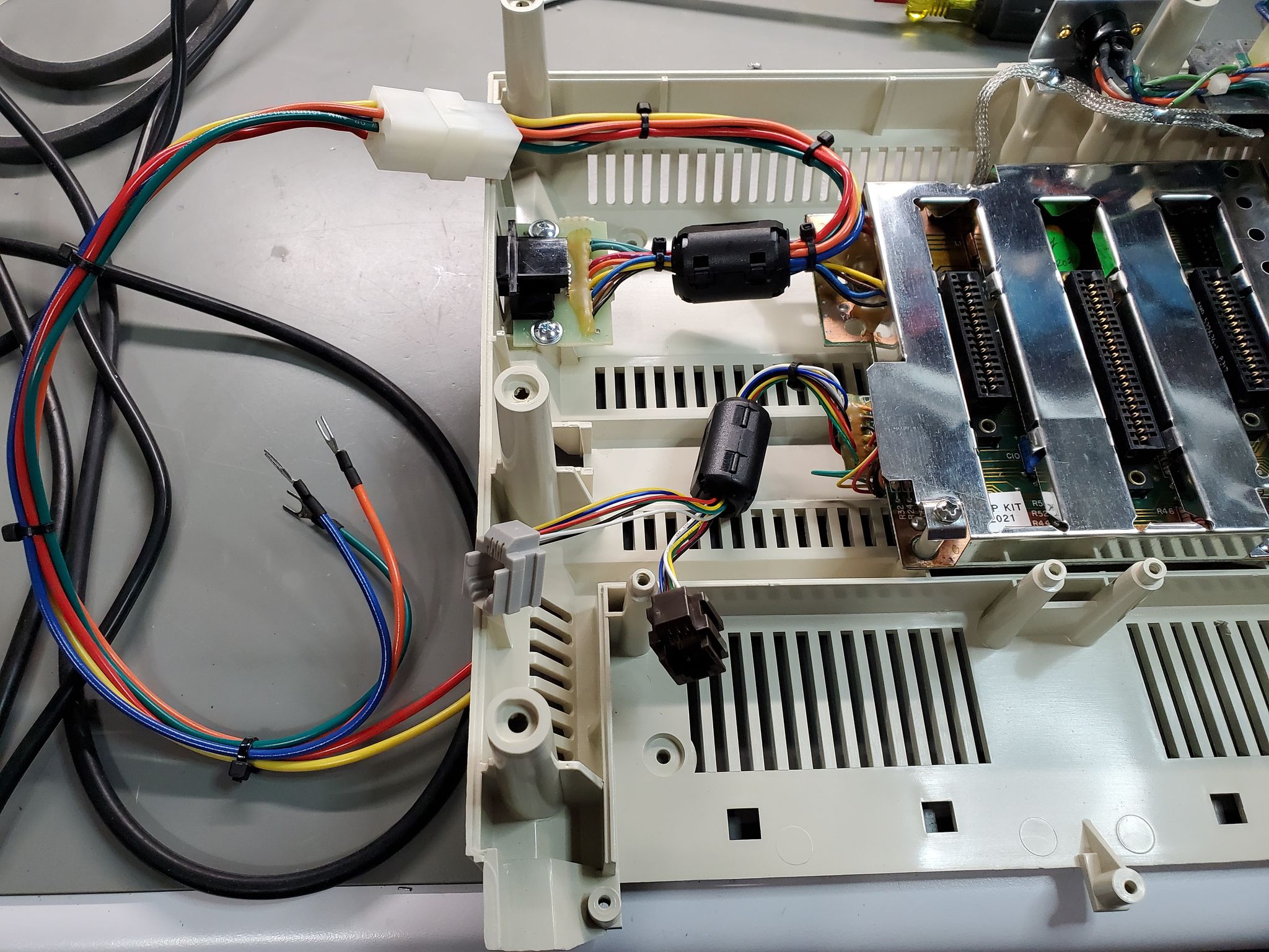

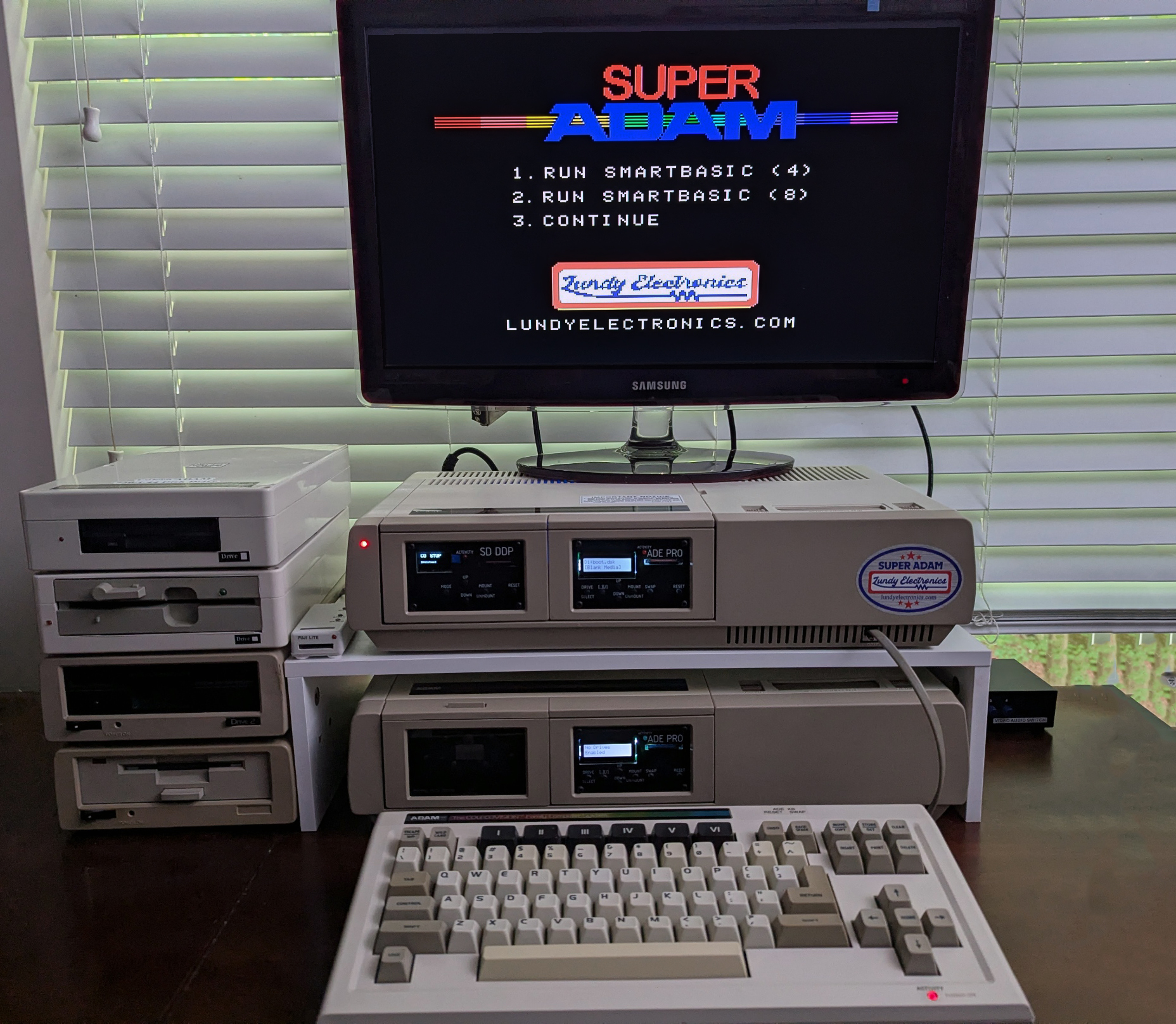

SuperADAM 2022
Modified by John Lundy (2022)
Power
Video & Audio
  • - C88 audio fix
  • - RCA audio connector

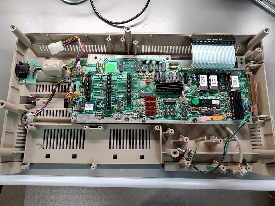

Board Upgrades
  • - Installation of console capacitor kit (also includes tantalum capacitors not supplied in other kits)
  • - New cartridge connector installation
  • - New all metal high quality 7-Pin DIN connector installation
  • - Ultrasonic cleaning of Gamma to Delta board connector and fingers
  • - Ultrasonic cleaning of existing 7-Pin DIN connector

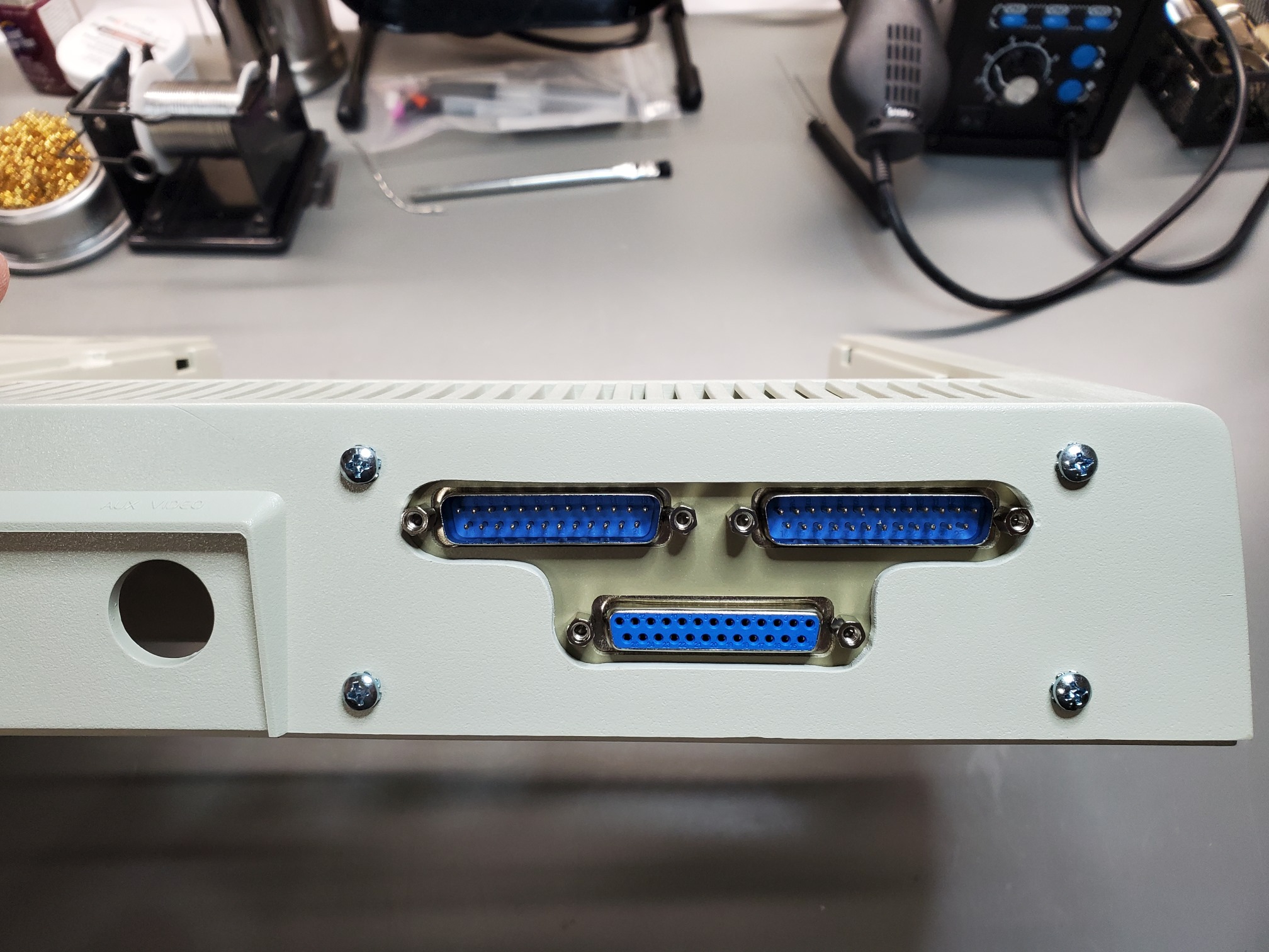

  • - Internal COM ports (2 serial and 1 parallel). *Requires an MIB238, MIB2, or MIB3 card
  • - Internal ADAMnet connection

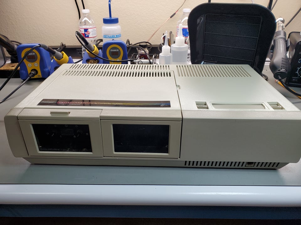

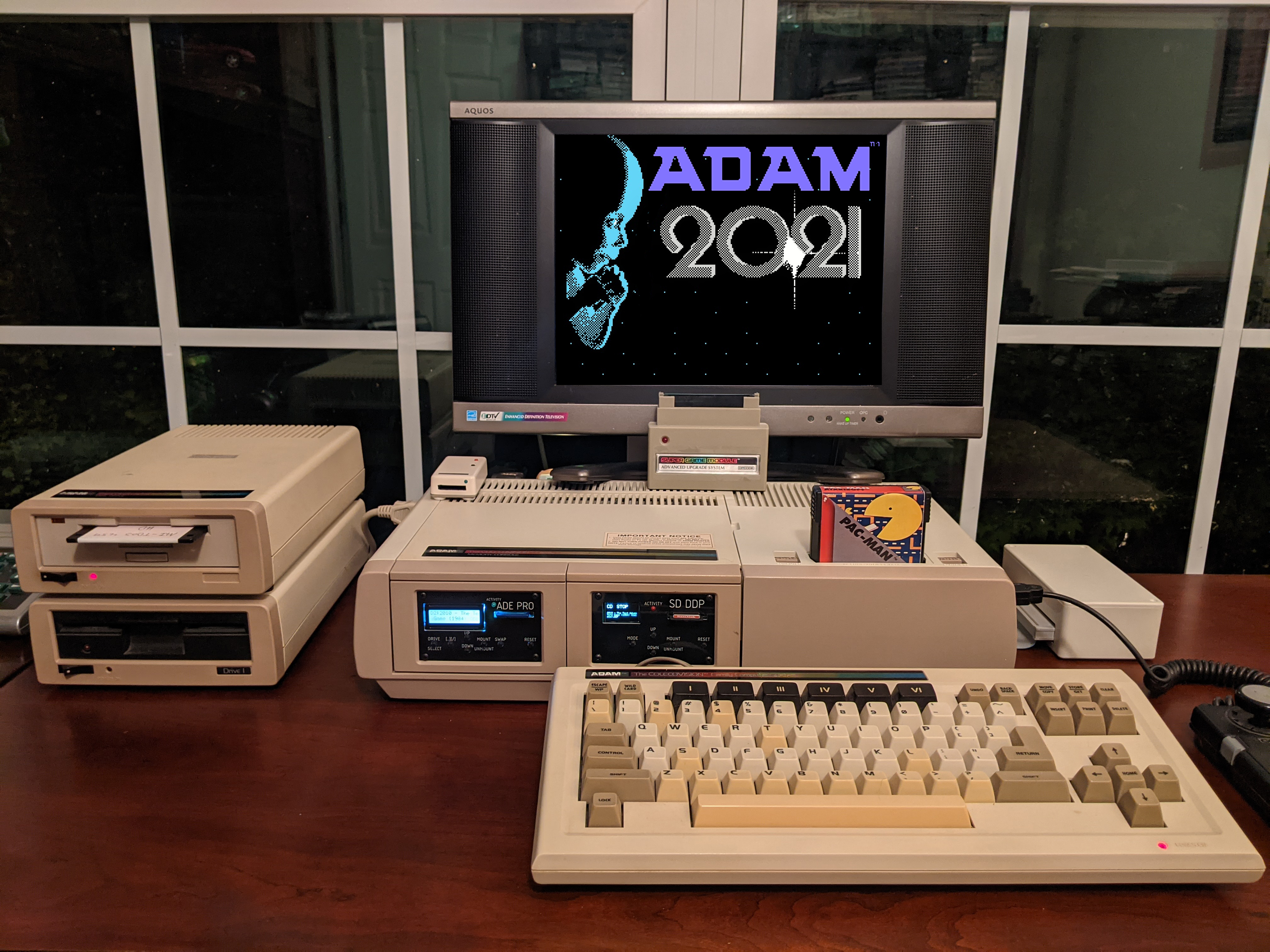

SuperADAM 2021
Modified by John Lundy (2021)
The original SuperADAM. The console that started it all — a fully modded ADAM with internal power supply, audio fix, and clean internal connectivity.

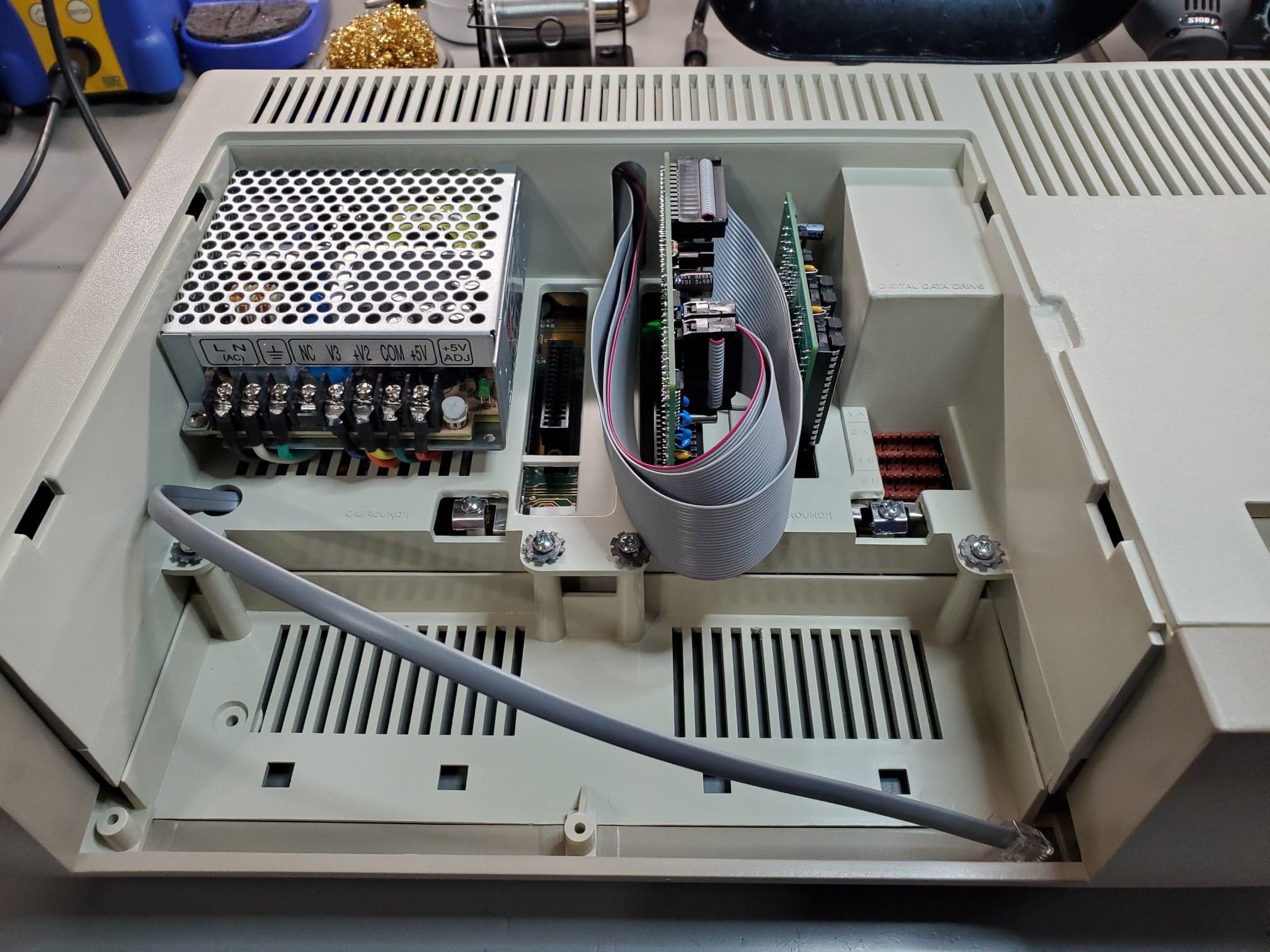

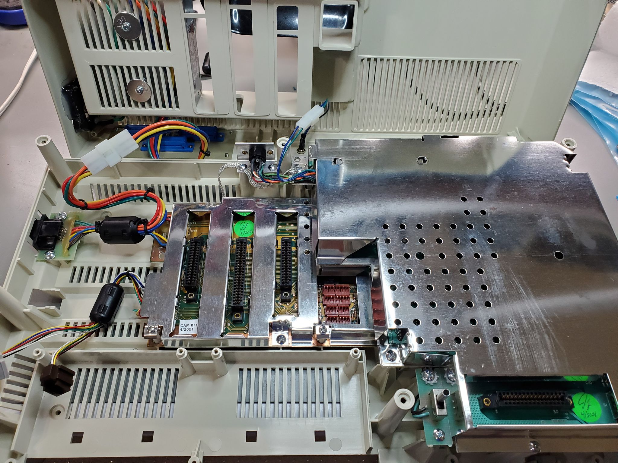

Power

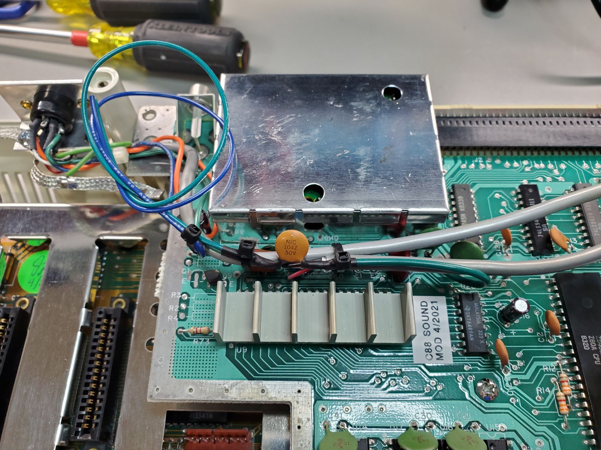

Video & Audio
  • - C88 audio fix

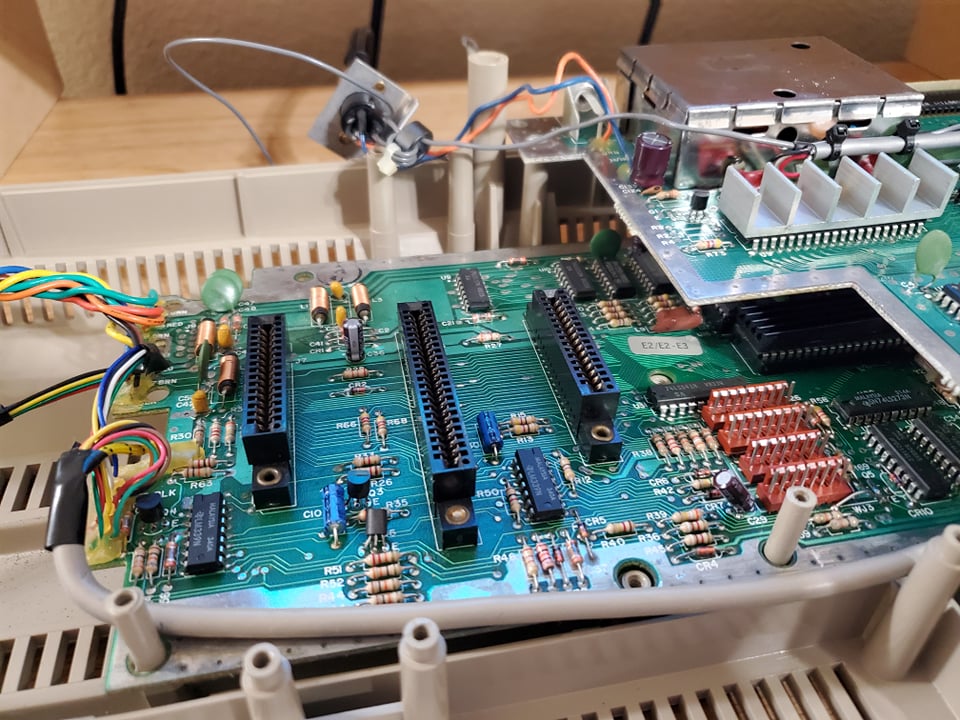

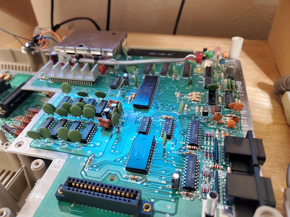

Board Upgrades
SuperADAM 2021 Gallery

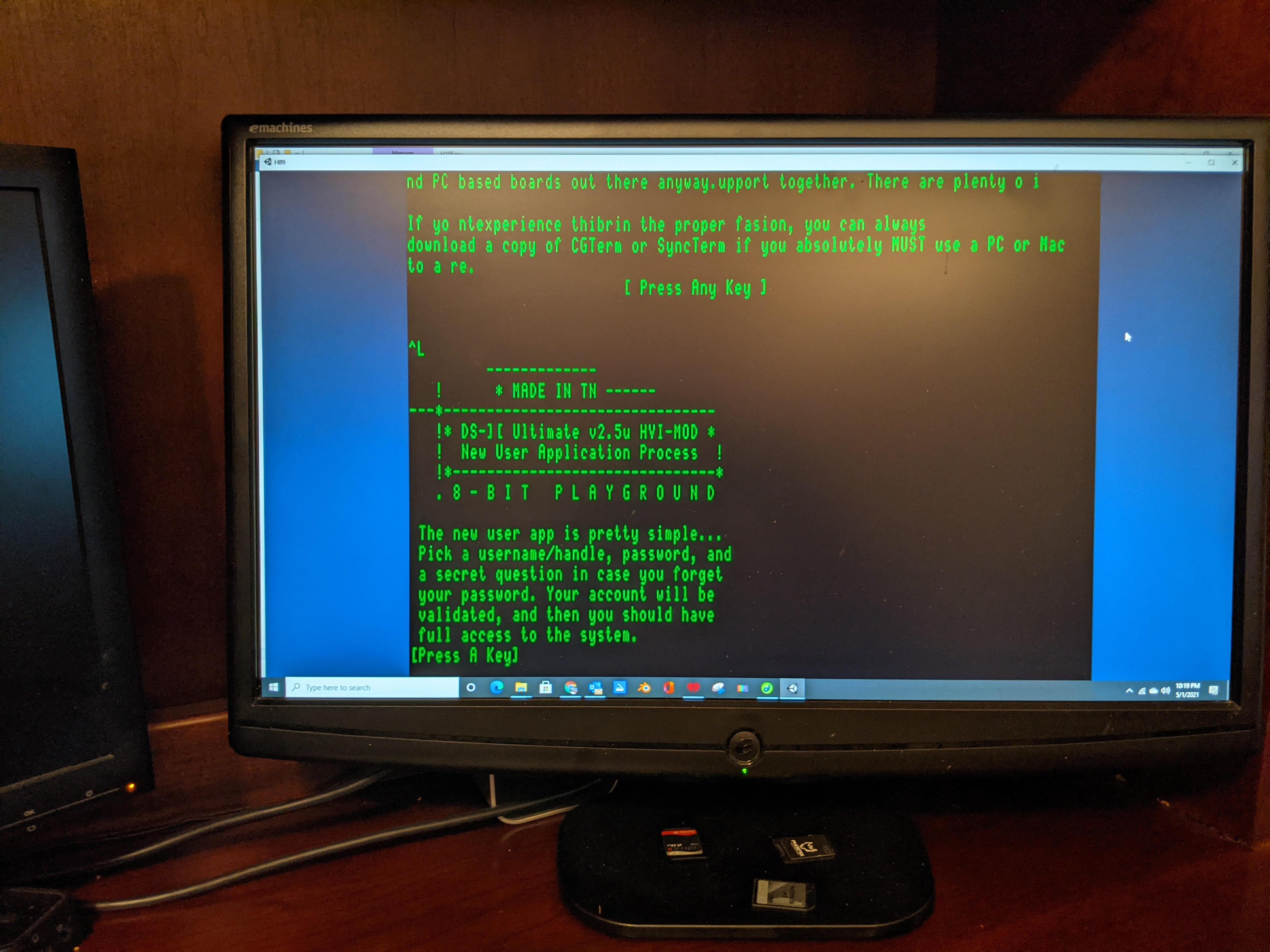

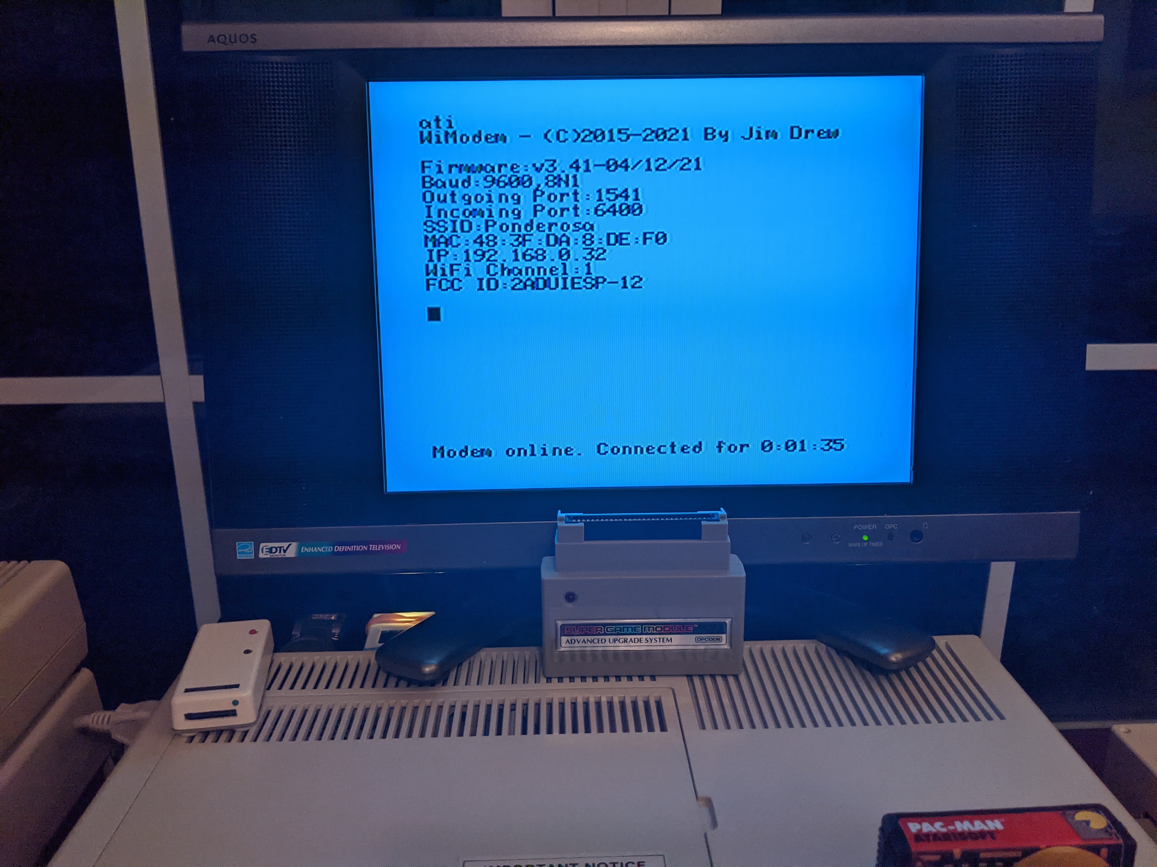

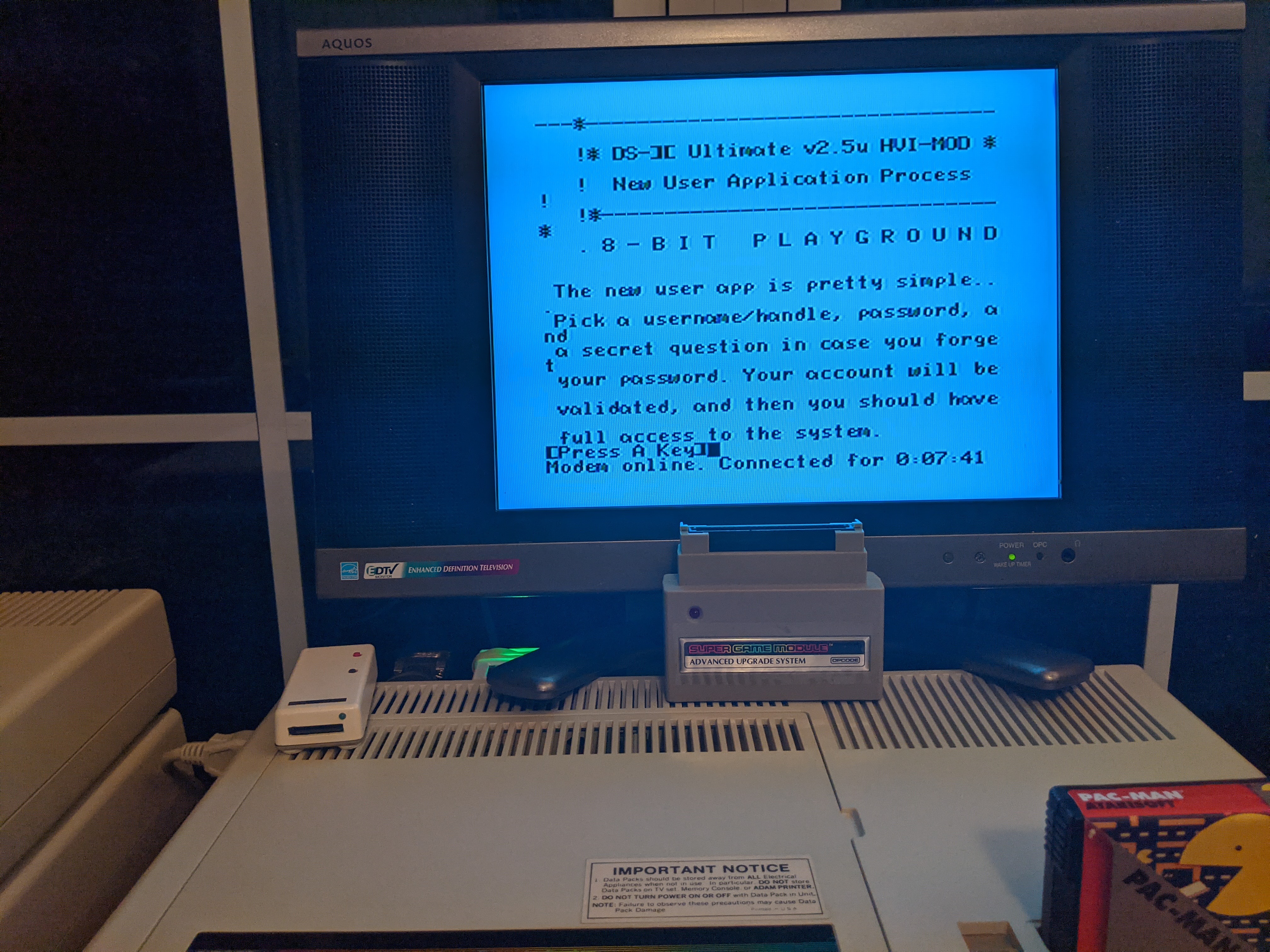

Online at 9600 Baud over WiFi and using 80 Column Terminal on a PC
